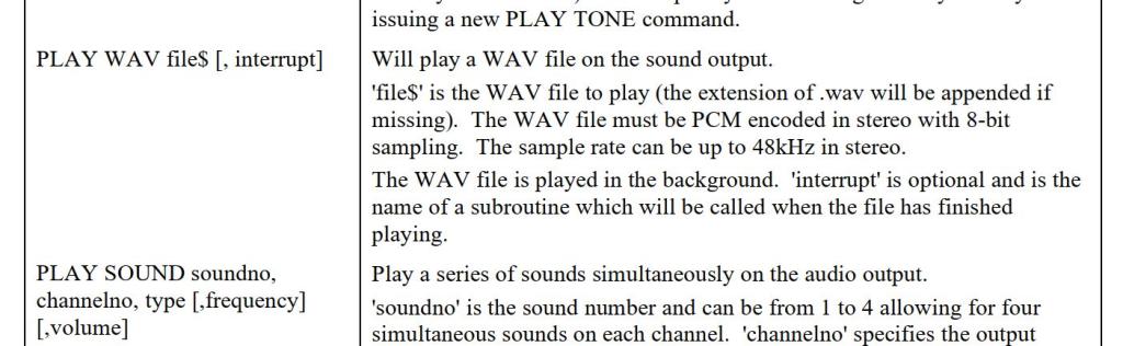

Can you use this with PLAY WAV, or is it only designed to work with PLAY SOUND or PLAY TONE?
I have seen plenty of examples of using PLAY SOUND and PLAY TONE in the threads, but no mention of being able to play WAV files off the SD card via this chip.
Yes you can?
No you can't?
Assuming you can, the manual mentions that WAV files have to be 8-bit sampling.
With the 12-bit DAC chip, can I assume that WAV files can now have 12-bit sampling?
Yes?
No, must remain at 8-bit?
Peter also mentions in one of his posts about the DAC, that it uses a bit more of the grunt of the 2040 processor then the passive L/C filter method does.  ROUGHLY how much more CPU does using the DAC involve?

The DAC can do everything the normal audio can including playing FLAC files
WAV files have always been able to be up to 16-bit. This is then truncated to 12 for the DAC and just over 11 for the PWM audio - don't know where 8-bit came from
The difference in processing is just that the audio interrupt routine has to output via SPI which takes a finite time. I haven't quantified this impact

Thanks very much, Peter.
8-bit thing came from manual(5.07.06, Rev 1), page 112:
Perhaps the manual is simply out of date now with respect to the new DAC feature etc.
Posts: 3364
Posted: 08:49am 06 May 2023
It is and will be fixed.  Thanks.
