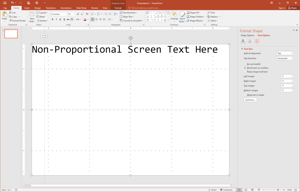

Powerpoint for me - I specify a layout (in inches, sorry) that corresponds to the screen dimensions (4.8"x3.2" for the 3.5" WaveShare Pico Eval Board LCD), then use the guides, rulers, size, and grouping tools to position items. Fixed (non-kerned, non-proportional) fonts come from the font selection drop-down, and I choose a font size that corresponds to the MMBasic fonts. I zoom the layout to fill my screen, and have at it.  The guides show me where things are on the screen.

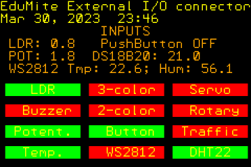

This may be a question for TassyJim?
Jim's FontTweak can already display a 480x320 grid that allows you to turn cells on/off.
Can it be modified to:
- have column/row IDs (ie x / y)
- display text as per MMBasic fonts
- maybe even draw a line/circle etc.
- save the display in a way that provides meaningful input to MMBasic ???
Jim has more than enough on at present (especially with good weather) but it is just a thought?
In the absence of such a tool I get by with:
- setting screens up as small (ie quick to load) programs until they are ready to be pasted into the main code
- knowing the width/height of each font (in the manual)
- in the TEXT etc commands; use temporary variables so a small change can be applied to multiple TEXTs etc.
- using the Console command mode to trial location options.

Posts: 6549
Posted: 01:58am 15 May 2023
It is something that I have thought about but not with a lot of enthusiasm.
I am not a GUI user/create so not the best to ask but I would look at MMB4W.
You should be able to create elements and save them as sprites. This lets you move them around easily.
If sprites don't work, just redraw as you move elements.
Either work at 1-1 scale or for those of us with tired eyes, use the built in commands to create the elements at 1-1 in a corner of the window.
At a regular interval, copy and paste them to a 'magnifier' area at 1-2 or 1-4 scale.
A simple menu to select the element and arrow keys to move it.
