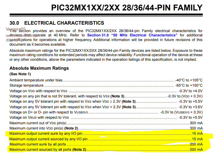

Hi all, is it possible to connect several digital out pins together on the Micromite in order to be able to draw more current? I have a HC-12 module here that runs in FU2 mode and consumes 16mA when transmitting. The Micromite can only supply 10mA per pin. Instead of putting the HC-12 module into sleep mode, I would rather control VCC from the HC-12 module via DOUT pins on the Micromite. Is that possible?
Best regards Artem

Absolute max rating per pin is 15mA and for all ports 200mA.... I think i will give it a try.
Is it possible to switch several pins to output high at the same time?

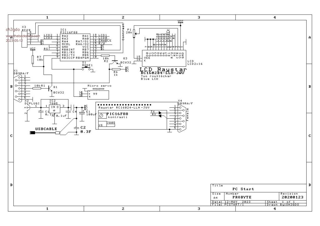

I had a similar problem with my servo device.
It has a PIC CPU and a servo.
I tried to turn power switch on with USB power, but it was only 0.5A capacity and servo doesn't work. I tried to add normal capacitors up to 2000uF.
Doesn't helped.
Then I ordered a super capacitor 0.3F 5.5V from Alibaba.
This helped me.

If you put a supercap in and switch it via a mosfet then you must fit a surge limiting resistor to keep the charging current below the maximum rating of the mosfet. It's like switching into a dead short.

No, I just put a super capacitor and tested it.
I works.
The PC limits USB current to 0.5A.
I used my old PCB and removed old power supply and replaced it with USB cable.
When the PC is sleeping, my PIC clock was looking the time with USB power and when
the time starts at morning, my PC starts with servo.
It pushed the on/off switch.
When we went to sleep. it pushed again the same switch.
Later I found a similar function in the PC, but it doesn't put PC off.
I found the same thing, which worked with HP PCs, but not with my HP550.
It is very slow PC, but suits for me. It sends the results to my Internet place and I can follow data at works.
It is used to log with my data logger.
