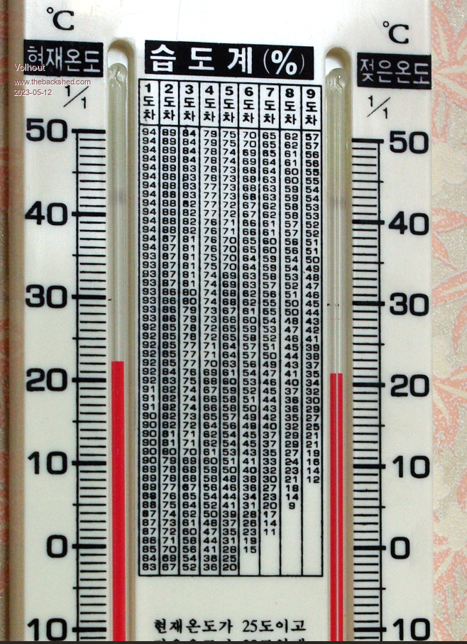

Looked at Wiki, found a picture that shows a physical device. My chineese is sub zero, but I think that the tables columns indicate the temperature difference and a certain level of the dry bulb (the wet bulb would normally not exceed 35C since humans would die, and there would be no-one to read the temperature).
This would require pretty accurate temperature measurement and calibration.
I'll play a bit with the idea. The good thing is that the wet bulb is easy to achieve since there are water pools in the habitat...

That Chinese table is the Mollier diagram to determine the humidity manually.
The two temperatures are measured with a ptc or ntc sensor.
In the greenhouses in my area (West of the Netherlands), measurement with dry/wet bulb is still used today, but due to regular maintenance, this is increasingly done with an electronic sensor.
The electronic versions have the disadvantage that they need to be calibrated, so it is more economical in practice to renew the entire sensor.
Two watertight DS18b20 sensors would work well and include the table in the microcontroller or by means of a formula. Do use good cotton stockings and a small auxiliary fan and demineralized water because the table is based on this.

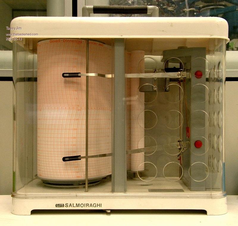

50 years ago I used thermo-hydrographs to record temperature and humidity.
The humidity pointer was controlled by a length of (usually) human hair.
I no longer have a supply of human hair to experiment with.
The drum was clockwork and the charts could be 24 hour or 7 days per revolution.
Edited 2023-05-13 10:45 by TassyJim

Yes, long ago also had to monitor air-con zones with thermo-hydrographs and a sling psychrometer (with wet and dry bulbs) to calibrate them. This had to be spun at a rate that gave an airspeed of 60km/h for the Rh graph that came with it to be accurate. There was also a correction table that required the barometric pressure for better accuracy. Distilled water was required for best results.
