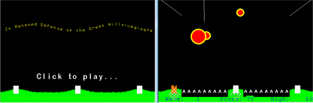

Here is VegiPete's "Renewed Defense of the Green Hills" #2, (a variation of Missile Command) converted from CMM2 for the PicoMite using an ILI9488 for the display and touch instead of a mouse. I had previously converted it for an LCD on the Armmite F4, but there were still some changes required.
The only real non-cosmetic change was to reduce the number of missiles from 48 to 32 because the PicoMite didn't have enough memory. Even when running the PicoMite at the top speed, with "OPTION CPUSPEED 378000", the pace of the game is, say, stately--just about right for my motor skills. (Note that "OPTION GUI CONTROLS 40" is needed for touch to be enabled.)
Pete's original code is here, but good luck, since it was published for the CMM2 2021 Programming Challenge, and is one dense uncommented block of code. At some point he provided a somewhat formatted and commented version which I used to make the port to the F4.
Here are the options:
OPTION KEYBOARD US
OPTION CPUSPEED (KHz) 378000
OPTION LCDPANEL ILI9488, RLANDSCAPE,GP21,GP20,GP17
OPTION TOUCH GP22,GP7
GUI CALIBRATE 0, 158, 282, 1252, 887
Here's a youtube video: Missiles on PicoMite
The color rendition of the video is terrible. I tried the cameras on two cell phones, and what is green to the eye and when the phone is two inches from the LCD is white when it is far enough away to frame the entire LCD. The orange with yellow bordered explosions are also not rendered accurately.
Here's the code: gh2.zip
For the F4 port, I had used MM.DEVICE$ to distinguish between CMM2 and F4. I continued that, adding the PicoMite. I tried to keep it so that this program will run on all 3 devices, but I didn't go back and check for the F4 and CMM2.
I ran up to wave 12 before I lost a base station and the program crashed with an array dimension exceeded while trying to erase the missile supply for that base. I've tried to fix that problem, but haven't gotten back to that condition, so it could crash still (or could crash for other reasons).
This is a really fine game which VegiPete wrote. It's a little slow on the PicoMite, but can still entertain.
Thanks, Pete, for your challenging and fun MMBasic games.

There are not many dynamic changes on the screen. It should be possible to make the game speed such that SPI speed is the bottle neck (determining factor).
Posts: 11844
Posted: 09:29am 17 May 2023
The way to make is much faster is to do all the work in a framebuffer and then use FRAMEBUFFER BLIT to move just the areas that have changed onto the physical display

  matherp said  The way to make is much faster is to do all the work in a framebuffer and then use FRAMEBUFFER BLIT to move just the areas that have changed onto the physical display
That is what I figured.
Do you know off hand approximately how long a FRAMEBUFFER BLIT of the full 320x240 display (ILI9341) takes ?
