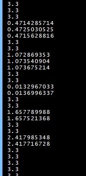

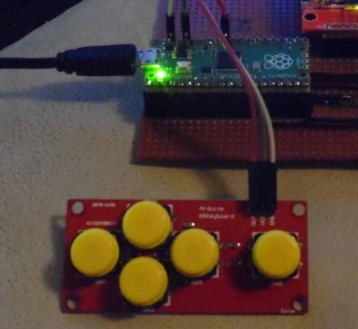

Hi. the quid button pads arrived and seem to work. Using at 3.3V though they're arduino so for 5V. results for up,down,left,right,right button.
SETPIN 31, AIN
do
PRINT PIN(31)
pause 1000
loop
Posts: 2807
Posted: 09:09pm 26 May 2023
this will be easier to case
SETPIN 31, AIN
do
bp=int(PIN(31)*1000)
PRINT bp 'PIN(31)
pause 1000
loop

It works well. My tron game is much more playable compared to touch area buttons.. and poking lcd screens is not good for them.Good button pad for the price of a mars bar and uses just 1 pin.

Touch buttons work but not too good with finger presses. The button board is much better and the buttons click when pressed but pressing 2 buttons at once needs another look at. Handy board for the price.

Mick, you have shown a way of case that wasn't obvious to me from the manual.ta
That float is fast I got to get used to...not used to it in microcontroller basic
the post was about the button pad and how cheap and it works easy with 1 a to d pin.
I'm impressed it's so simple yet works. switches and pull ups and de bounce and wires and lots of gpio pins l8r. for 5 buttons this is handy.. in the spirit,hobbyist
