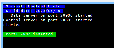

In W11, right click on start button and select device manager.
But there is no need.
Start MMCC
plug your micromite in and MMCC will tell you which port just arrived/departed.

Thanks Jim - that works.
