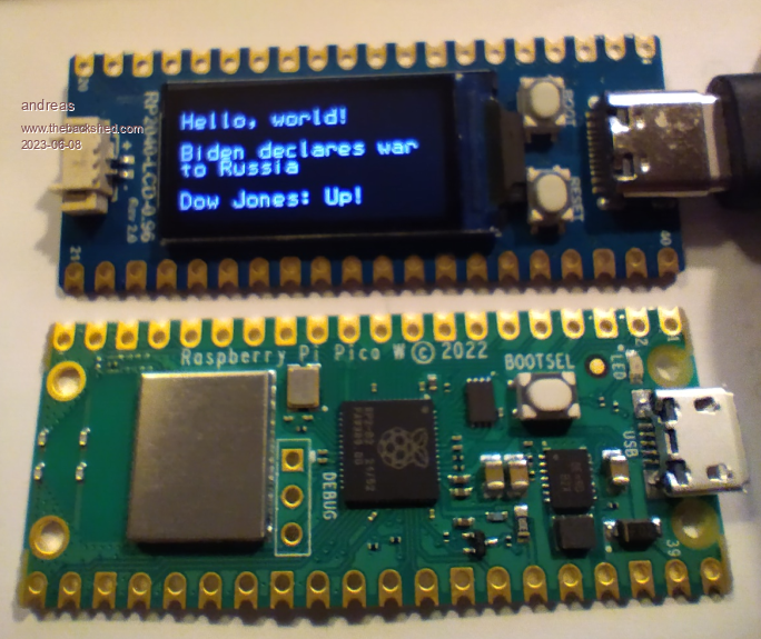

I have a dream.
Two (or more?) picos cooperating, each one contributing its special features.
For example use pico-1 (RP2040-LCD) as display and use pico-2 (pico w) as interface to the world. This way pico-2 could use its excellent internet capabilities to get information i.e. extract news from a website, which could be displayed by pico-1.
Question: What would be the best method to interconnect the two picos using PicoMite/WebMite ?
-andreas

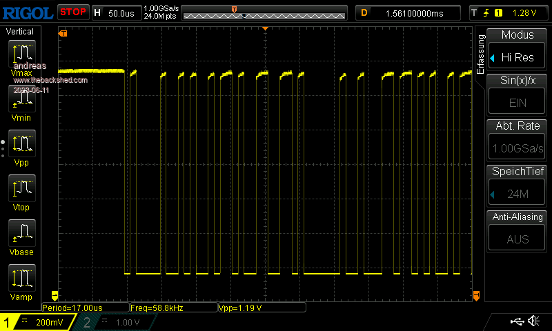

I did a PCB some time ago that takes a PicoMite and a PicoMite VGA (The PicoMite Pear). I allowed the user to link them using COM, I2C or SPI or anything similar that can be fitted into 4 IO pins IIRC. :). Of course, you can leave off the VGA and mess with the IO pins to your heart's content...
COM ports have a big advantage in that there is a receive buffer so the receiving device doesn't have to continually scan for new incoming data.
SPI has the advantage of speed, especially if you want to swap data quickly but it can be fiddly unless you are using fixed length messages.
I2C has the advantage of very simple multi-processor communication.
Parallel bus can be extremely fast at the expense of IO pins.

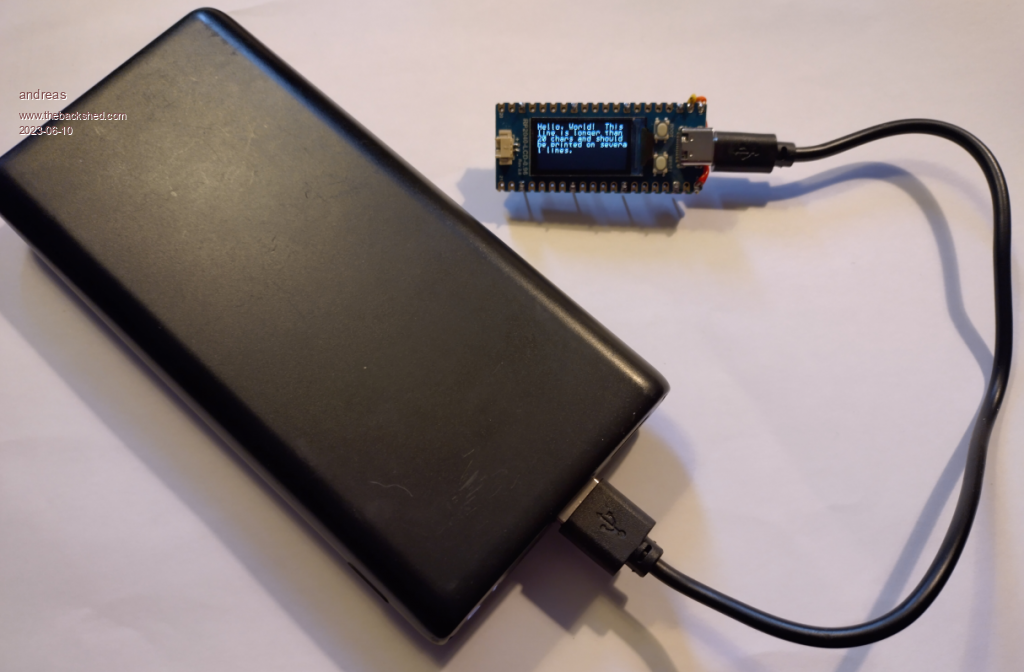

andreas
Joined: 07/12/2020
Posts: 226
Posted: 11:37am 10 Jun 2023

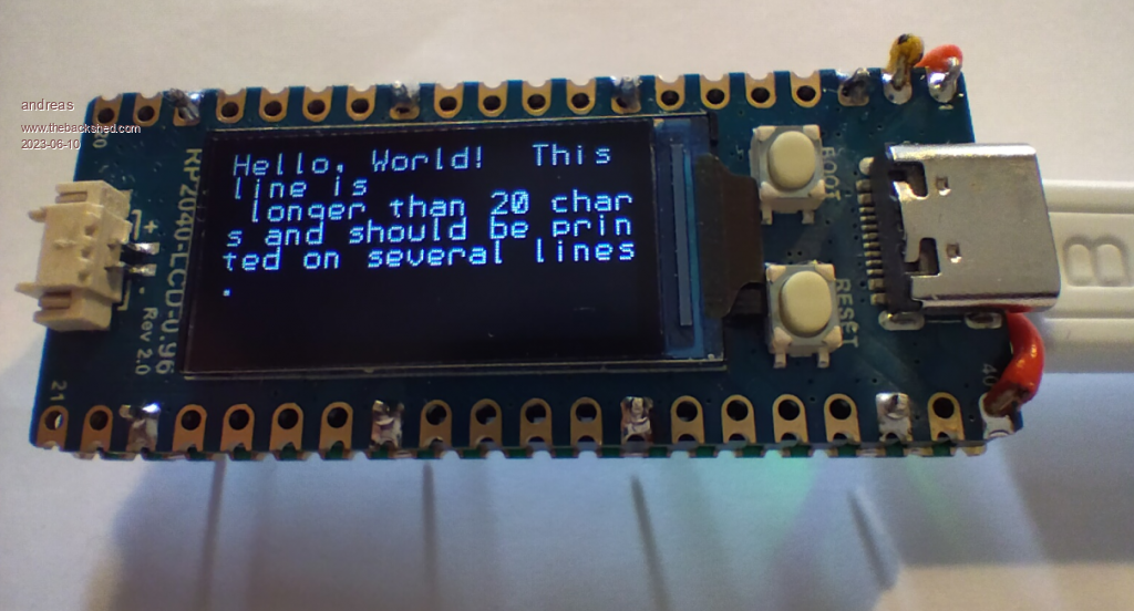

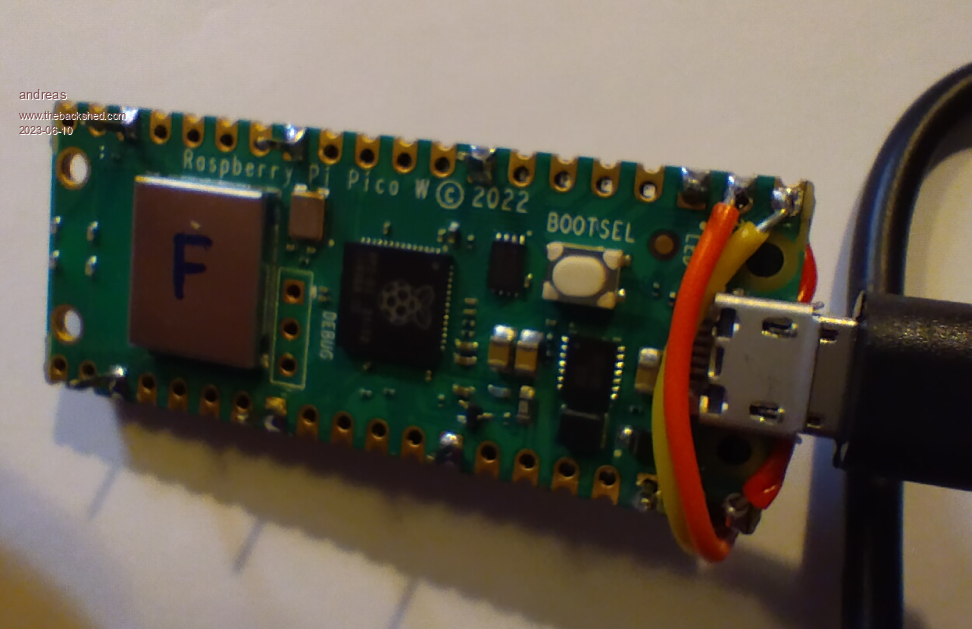

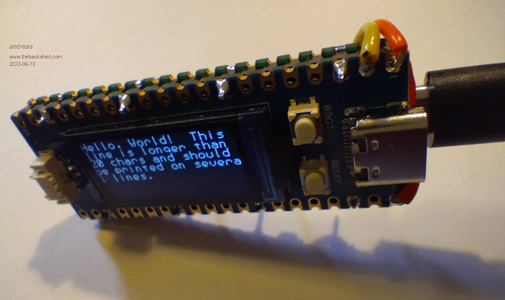

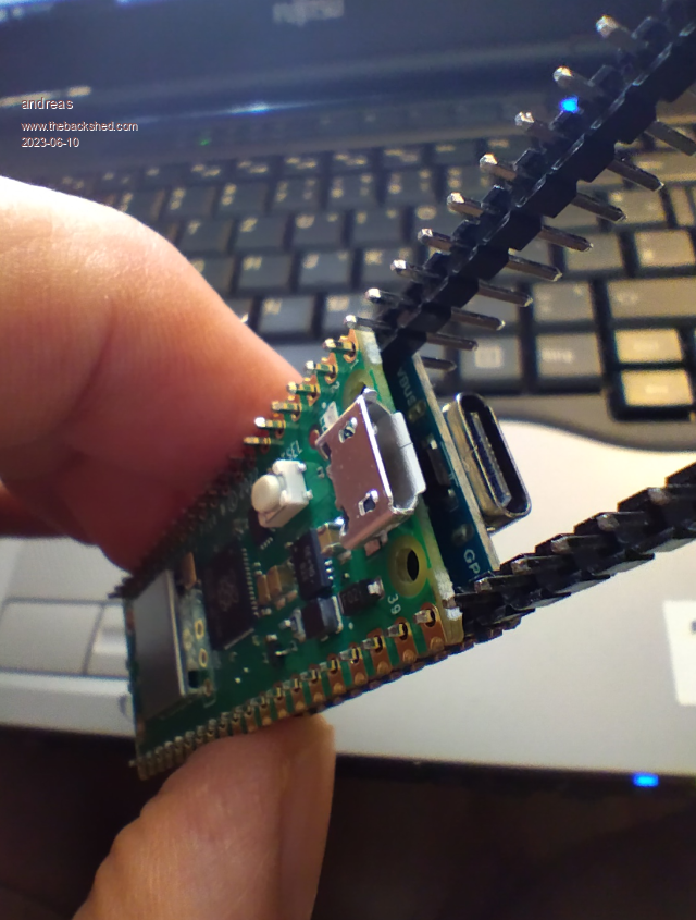

Hello all,
here it is: The WebMiteLCD :-)
Step1: putting them together this way
WebMite on top, RP2040LCD on the back
Soldered are: GND(8x),VBUS,GP0 and GP1 (Null modem, crossover)
All other header pins are dragged out after soldering GND lines

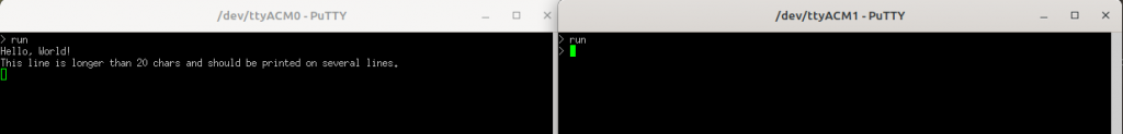

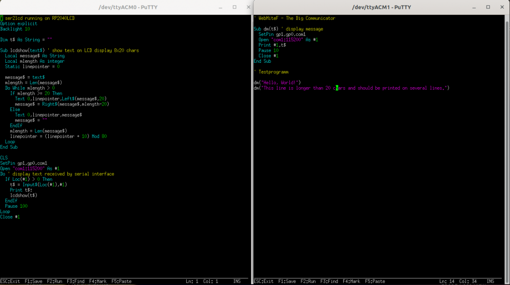

Step2: The Software
Left side: RP2040LCD showing everything received by COM1:
> list
' ser2lcd running on RP2040LCD
Option explicit
Backlight 10
Dim t$ As String = ""
Sub lcdshow(text$) ' show text on LCD display 8x20 chars
 Local message$ As String
 Local mlength As integer
 Static linepointer = 0
 message$ = text$
 mlength = Len(message$)
 Do While mlength > 0
   If mlength >= 20 Then
     Text 0,linepointer,Left$(message$,20)
     message$ = Right$(message$,mlength-20)
   Else
     Text 0,linepointer,message$
     message$ = ""
   EndIf
   linepointer = (linepointer + 10) Mod 80
End Sub
CLS
SetPin gp1,gp0,com1
Open "com1:115200" As #1
Do ' display text received by serial interface
 If Loc(#1) > 0 Then
   t$ = Input$(Loc(#1),#1)
   Print t$;
   lcdshow(t$)
 EndIf
 Pause 100
Close #1
Right side: WebMite sending a text$ to COM1:
> list
' WebMiteF - The Big Communicator
Sub dm(t$) ' display message
 SetPin gp1,gp0,com1
 Print #1,t$
 Pause 10
 Close #1
End Sub
' Testprogramm
dm("Hello, World!")
dm("This line is longer than 20 chars and should be printed on several lines.")
-andreas

Hello lizby, very good stuff - I will test it!
Currently I'm using this(the code changes every minute;) to get a CLS command send over the line - but yours is more flexible. I was even thinking about some kind of "POSTSCRIPT" language to send by the serial line;)
 If Loc(#1) > 0 Then
   Select Case t$
     Case "CLS"+Chr$(13)+Chr$(10)
       CLS
       linepointer = 0
     Case Else
       lcdshow(t$)
   End Select
 EndIf
 Pause 100

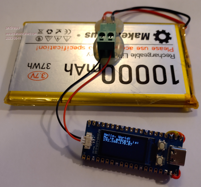

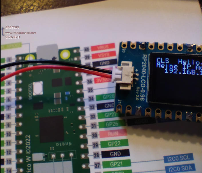

Today I have received tiny cables with a connector fitting into the tiny accu connector of the RP2040. The colours are wrong (black and red!). Then I saw that it would be better to connect VSYS to VSYS and not VBUS to VBUS as I did it. The diode seems to "protect" the WebMite pico w from power sourcing from the battery connector of the RP2040. So I will change that hardware design.
-andreas

The on-board diode from VBUS to VSYS is to prevent a back-feed from the Pico to the USB port of the PC. That can damage the USB chip of the PC, which is not considered to be a "good thing"! It doesn't matter if the USB socket is the only source of supply.

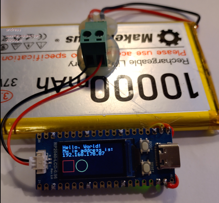

..even graphics is working:
' dm-lines starting with "!" will be executed as BASIC code from the LCD unit
 SetPin gp1,gp0,com1
 Print #1,t$
 Pause 10
 Close #1
End Sub
Sub clearLCD() ' clear LCD
 dm("!CLS")
 dm("!linepointer = 0")
End Sub
' Testprogram(m)
clearLCD
dm("Hello, World!")
dm("My ip address is:")
dm(MM.Info(ip address))
dm("!Box 0,40,30,30,,rgb(red)")
dm("!Circle 50,55,15,1,1,rgb(yellow)")
-andreas
