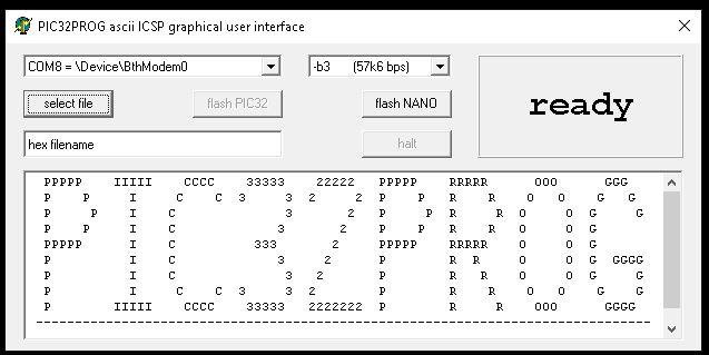

Hi Gurus,
I am getting problems with a project that previously worked fine, (about 18 months ago), but now shows erratic behaviour.
It is MM+ E100 based, backpack style with a 5" screen, board version v1D - the one with the Microbridge on-board. I'd like to reload the firmware in case it has got corrupted in the interim, which is v5.05.03.
Previously I had a Win XP system to do this, and download programs too, but now I have a Win 10 pc. I have copied all my files from the XP system to this new pc, but am having a problem using Serge's "pic32prog.exe" to reload the v5.05.03 firmware.
When run in the command window - pic32prog starts with the copywrite and adapter header, but then gives the message "No target found". The MODE led goes out and the E100 screen cursor resumes flashing.
I gather a driver was required for pic32prog - downloadable from Microchip for the MCP2200 (Microbridge) equivalent from :-

Posted: 08:36pm 24 Mar 2021
hi peter,
  the simplest way (under windows) is to use p32p_gui from here:
http://www.thebackshed.com/docregister/ViewDoc.asp?DocID=21
ensure that "pic32prog.exe" and "P32P GUI.exe" are both in the same folder, along with any .hex firmware file you wish to upload to your pic32.
double-click on "P32P GUI.exe" to launch the program. select the comm port that the nano is attached to from the dropdown menu, then click on the 'flsh NANO' button. all going well, the 'ascii icsp' firmware should be uploaded to the nano (ensure that there is no jumper on the nano's RESET pin).
now you can use the 'select file' button to select the .hex file to write to the pic32, then click on the 'flash PIC32' button to upload it.
rob   :-)

Posts: 9996
Posted: 12:33am 10 Jun 2023
Paul, the 1455 chips appears to be working fine.  Your LED descripton matches what the chip is supposed to be doing.  If you CAN talk to the console via a terminal and the 1455 chip, then Windoze sees the chip and is talking to it fine.  You SHOULD be able to simply select the correct COM port, and reprogram.  SHOULD be.
To use PIC32GUI.exe, simply copy it and pic32prog.exe into the same folder(that should be the case now), and double-click on PIC32GUI.exe.
Windoze MIGHT moan about it not being an approved app.  If you get that, click on "More information" or "Tell me more" - something like that down the bottom of the window(it's a text-type link, not a button), another window will open, and in that one click "RUN ANYWAY".  You only have to do that once.  Windoze will remember for the next time.
Select the COM port from the drop-down list box at upper-left of the window that opens, press the SELECT button on the E100(MODE LED should light AND STAY LIT).
Click on select file, locate and open the HEX file for the firmware you want to load.
You should be brought back to the GUI window, from there, click on flash PIC32
Everything SHOULD just flow nicely from that point on.  Keep us updated.

Sorry about the delayed response to this thread. Having run "P32P GUI.exe" I get exactly the same message as above.
I have reseated the '1455 in case there was a problem there, but no joy.
Using "pic32prog -d ascii:com8 -b8" I got the message :-
