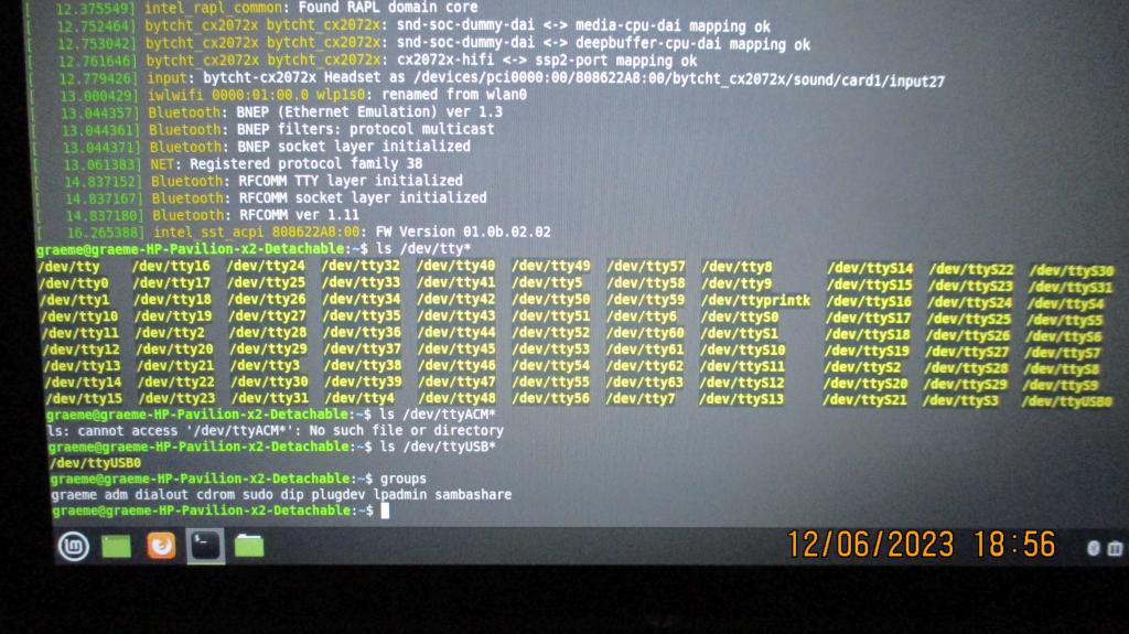

I'm trying to get a Prolific USB-serial adaptor working in Mint 20, but Mint basically refuses to see it or talk to it, BUT Mint knows it is there.
I have a feeling, I have to add the device to the dialout group, but I forget how you do that, as I don't use Linux commandline on a daily basis.
Can one of the Linux gurus here please help?
I am trying to use the adaptor with PuTTY, but PuTTY refuses to even SEE the adaptor, so the problem is two-fold:
1) I need to make Mint allow PuTTY to "SEE" the adaptor at a standard Linux serial-port path such as /dev/ttyACM0
2) I then need to add myself to the dialout group, as I think that is disabled by default, and you have to have that enabled to allow use of serial ports in Linux.
Thanks for any help.

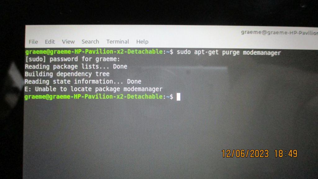

You have to be a member of the dialout group.
You have to logout and back in for it to take effect.
You might have to get rid of modemmanager
sudo apt-get purge modemmanager
The commands to get rid of it may vary. Search the forum.

to see the groups you are in: groups
to add an existing user to an existing group:adduser <user> <group>
ls /dev/
plugin device
ls /dev/
..and compare what changed ;-)
or
dmesg just after plugging in the device
-andreas

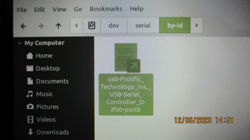

@ Quazee137: This is the output I get from those commands...
From what I can tell from this, I am already a member of the dialout group, and I think the Prolific adaptor is at /dev/ttyUSB0.
Inside PuTTY, I cannot select /dev/ttyUSB0.  All it will let me select is /dev/ttyS0.
I cannot backspace and even TRY to type in the USB0 location - backspace has no effect.
EDIT: Hold the phone - In PuTTY, right down the bottom of the config window, under Category, I can enter in the /dev/ttyUSB0 reference there, and it seems to open OK.

Modemmanager,
NOT
modemanager!
Posts: 10038
Posted: 07:14am 12 Jun 2023
Yes, I should have thought of the loopback test!
However, I had a thing on the bench ready to connect to it, which I knew worked on the same Prolific adaptor and a Windoze laptop, so....
  Quote  Modemmanager,
NOT
modemanager!
F-ing Linux!
Totally missed that extra "m" - very well hidden.....
In any event, it did not seem to matter, as the COM port is working now.

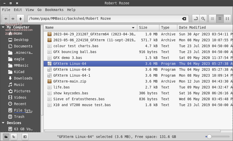

GFXterm's new home is here:
https://github.com/robert-rozee/GFXterm
the binaries folder contains pre-compiled binaries for 32- and 64-bit linux, as well as win32. in theory, it should also be possible to compile for RPi.
new changes are:
1. anything being pasted that is only one line long now does NOT have a carriage return appended (as requested by Frank N. Furter), and,
2. there is now a new menu option, "screen size" that enables you to manually set the screen size to anything between 40x16 and 160x60. this should accommodate the needs of the pico versions of MMbasic.
rob   :-)

I have now removed modemmanager using the extra m this time.  It completed without errors, so that should now be gone.
EDIT: @ Rob - Can download the file, but Mint does not know what to do with it.  Mint moans that the file has no application associated with it.  The file has NO extension, and the W10 machine I downloaded it on, just refers to it as filetype "File".
Do I need to rename and add an extension perhaps?

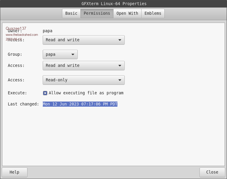

Posts: 2552
Posted: 02:21am 13 Jun 2023
right-click on the file's icon and select 'Properties' from the menu. this will bring up a window with three tabs, the right-most is the one you want, 'Permissions'. here you will find a checkbox with the text "Allow this file to run as a program".
check this checkbox, this will then allow the file to be run.
with linux, extensions don't have any special meaning in the same way as they do with windows, so no need to rename anything.
rob   :-)

Quazee137
Joined: 07/08/2016
Posts: 603
Posted: 02:23am 13 Jun 2023
bring up nemo or other file mgr you use
right click on
click box
from here on in it should just run.

Posts: 10038
Posted: 03:51am 13 Jun 2023
Excellent, thanks chums!
All up and running.
