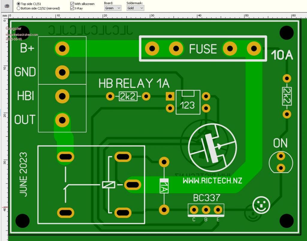

Hi all.
Many modern cars now have LED headlights, and more then that, those LED headlights are controlled and monitored by the car's computer unit.  Any excessive current flow in the headlight circuit will cause the computer to go into an error state, as will ZERO current in those circuits - the computer will conclude the lights have failed, and will indicate as such.
So, the days of just paralleling extra lights onto the high-beam circuit are gone with modern cars and car computers, and also modern cars use much thinner wire for the headlights, as LED's are much more efficient then old halogen or globe-type bulbs that were used for headlights in the past.
A chum of mine needed to interface a pair of 50W halogens to the standard HB circuit, but could not directly connect, and could not even put a relay on the HB circuit, as the car computer decided that the relay current was a fault condition!
So, this circuit was born.  5mA load to the computer-controlled HB light circuit, but switches the big-boys on via the battery, a protection fuse, and a 10A relay.  The relay and load current are totally isolated from the car-computer HB circuit.
PC123 opto-coupler to the HB circuit, paired with a standard BC337 in a Darlington arrangement, to drive a 12v relay coil.
Let me know if anyone thinks this is useful enough, and I can post a constructor pack.

what is the relay's coil resistance? when turned on, the BC337 will see 0.6v across collector to emitter and so will at the least get warm. google says that a headlight relay's coil typically draws 150-200mA.
i would suggest either:
1. cut the track running to pin 4 of the optocoupler and connect pin 4 to B+ via a resistor of perhaps 1k5. this will ensure that the BC337 is fully saturated when on.
or:
2. leave out the optocoupler completely and bridge between pins 1 and 3 of the optocoupler's footprint - this would mean HBI is connected via the existing 2k2 resistor to the base of the BC337.
btw, did you intend that the LED be permanently illuminated? as shown it will permanently draw a few mA from the battery and create a (red) glow from wherever the PCB is mounted. the current draw is likely far less than existing parasitic losses within the car, but the glowing LED may be an annoyance.

Why would the BC337 stay warm? Not unless the opto is conducting. There's no other base current. Not sure what the opto is, but I assume it's the usual collector and emitter output and it shouldn't conduct normally. It would have been nice to see a pull down resistor from the base of the BC337 to reduce leakage though.
Agreed, the opto is perhaps a little bit of overkill. I like to put a zener in series with the input resistor (e.g. 1-3 of the opto position), say 8V, so that the transistor turns on when the control input is Vz+0.6V and drops out cleanly when the input falls. Of course, the opto will be needed if the input circuit needs isolation from ground.

I suspect that the HB wire will simply be connected to the high beam headlight, but via a current monitor in the computer. It'll be 12V. The B+ will be 12V via a heavier wire from the fuse box (I hope! The wire needs protecting). There is no bus connection so this would work with any version of any bus  :).
