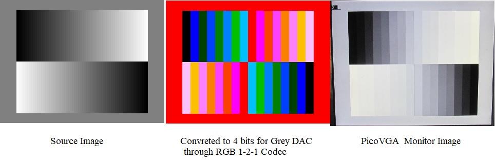

A few people were interested in Grey-scale and RGBI output for the PicoVGA.
Here is the Grey-scale installment with a simplified DAC, RGBI to follow also with a simplified DAC.
Adgust the trim-pot to get a uniform scale. The MSB needs more current than is good for a Pico pin hence the transistor. It doesn't need much gain but does need to work at a high frequency. The diodes reduce interaction between pins. The LSB doesn't need one as it's effect is least significant.
Below is an array of colour constants to use instead of RGB(xxx) for display commands.
They generate the required bits on GP18 (LSB) to GP21 (MSB).
The PicoVGA only uses the Most Significant Bits of each of the 3 bytes in the 24 bit RGB values. For red and blue it is 1 bit and 2 for green, the rest of the bits don't affect the output.
Eg. GP18 is low for 1 to 127 and high from 128 to 255 (between line and frame blanking periods).

Images must first be processed to convert the colours as the PicoVGA codec expects to output to RGB 1-2-1 hardware. A normal greyscale image will come out B&W on the monitor as black and white are the only grey-scale colours.
This program first makes a normal image then converts it to the format required by this hardware.
To keep it simple this is done by loading the image to an LCD screen, reading the pixels, converting the values and writing them back to the screen. One pixel at a time so it is slow!
This cannot be done on the PicoVGA as more than 4 bits/pixel are needed. I used an ILI9488 that returns 18 bits/pixel, though it could be adapted for MMB4W for 24 bits/pixel.
To convert other colour or grey images delete the first section.
It assumes the source image is 320 x 240 pixels.

'Convert an image for grey-scale hardware on PicoVGA (through the RGB121 Codec)
Dim Integer x, y, Ri, Ro, Gi, Go, Bi, Bo, Pix, Mono
Load image "b:\greyscale 4.bmp"
Pause 500
Toggle = 0.5
 For x = 0 To 320
  For y = 0 To 240
   Pix = Pixel(160-x*toggle,y)  'read back the pixel values
  'extract the input colours
   Ri = Pix >> 16
   Gi = (Pix >> 8) And 255
   Bi = Pix And 255
   Mono = (Ri + Gi + Bi) \ 48  'convert to 16 level greyscale
  'Create RGB121 output colours that will decode on grey-scale hardware
   Ro = (Mono >> 3) * 255
   Go = ((Mono >> 1) And 3) * 64
   Bo = (Mono And 1) * 255
   Pixel 160-x*toggle, y, RGB(Ro,Go,Bo)

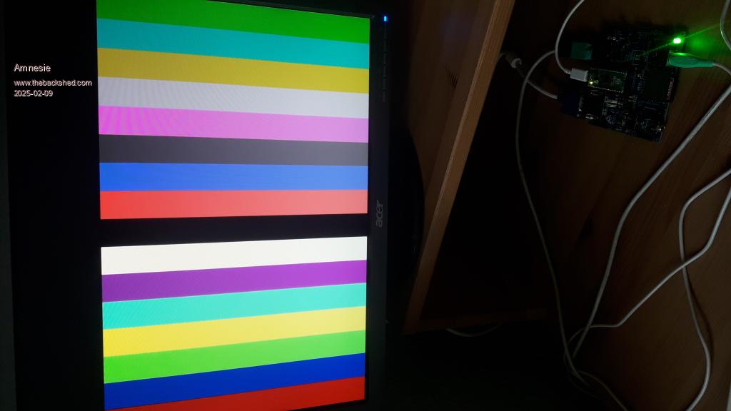

Here is part two, RGBI
Table of colour constants - Number following the colour letter is the bit value. I = intensity. Replace my cryptic names with the colours you see.

You may need to experiment with resistor values to get the effect you want, however this simplified circuit will never be perfect. I tested a couple of much more complicated ones but overall are no better than RGB 1-2-1. With only 4 bits any improvement in one aspect of an image is at the expense of another.
Others have produced better image quality using dithering on RGB 1-2-1. The compromise there is that to minimize the "spottiness" you need to view from a distance (or take your glasses off).

On the monitor I count 16 colours, though the differences are not great.
With the intensity bit low:-
black, blue, green, cyan, red, magenta, yellow, light grey.
With the intensity bit high:-
dark grey, light blue, light green, pale cyan, pink, pale magenta, pale yellow, white.
The I bit adds brightness to all colours simultaneously, desaturating them.
As noted previously it isn't worth the the effort, different but not better.
A few others were interested in the idea so now they have a starting point for their own experiments.
Edited 2023-06-18 18:53 by phil99

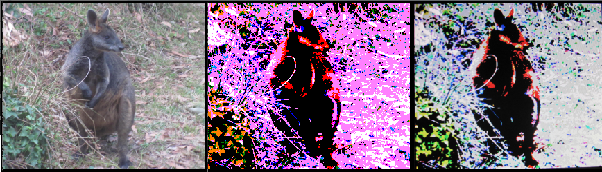

A comparison of the three decoders.
In this instance RGBI looks a little better than RGB121 as it can display 2 shades of grey. In some other images RGB121 is better.
However greyscale is best.

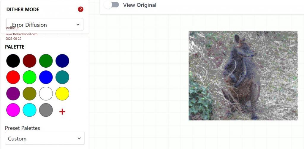

Have you used the dither website to do the conversion?
You can select algorithm's how to optimize the resulting picture, and you can feed it a colour pallet.

Yes, dither does a better job of rendering the colours than the simple colour substitution used above. The tradeoff is effective resolution. you need to be far enough away for adjacent dots to merge to get the correct effect.
It is equivalent to the R, G & B sub pixels on a TV screen. There is no yellow, brown, purple etc. It works because the sub pixels are too small to be individually resolved at normal viewing distance.
On the PicoVGA Mode 2 they are Big.

This is FloydSteinberg on your (grabbed) original picture on Pico RGB-121 in 320x240. Yes, it is noisy, but it is clear what it presents.

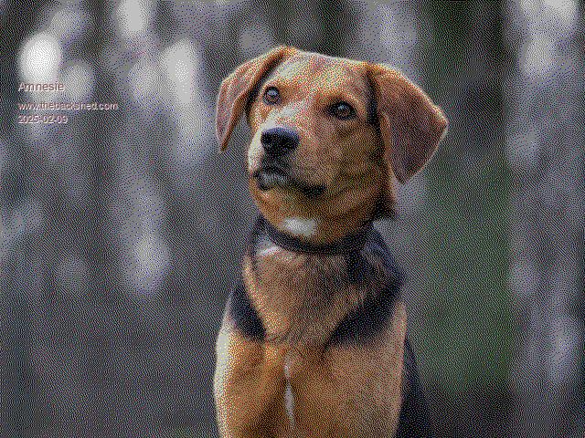

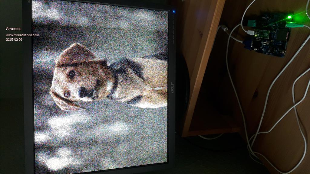

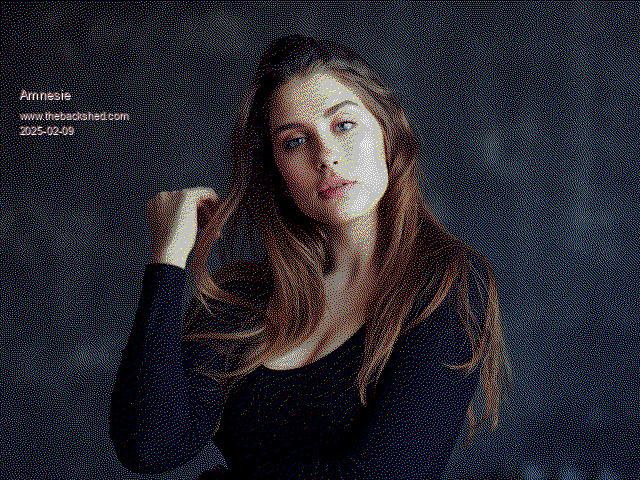

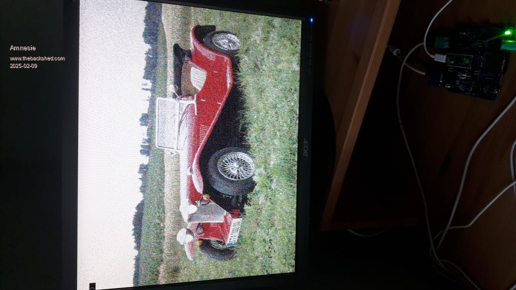

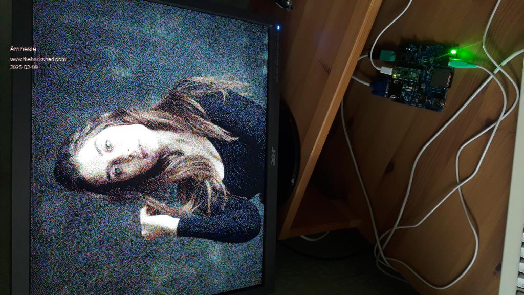

Posted: 10:04am 09 Feb 2025
Hello,

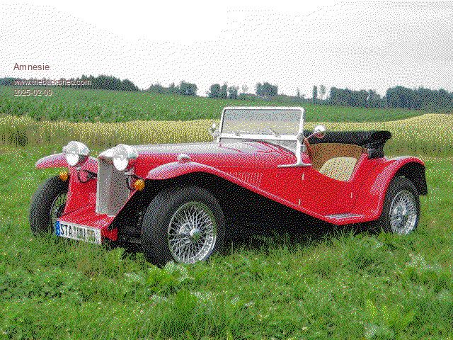

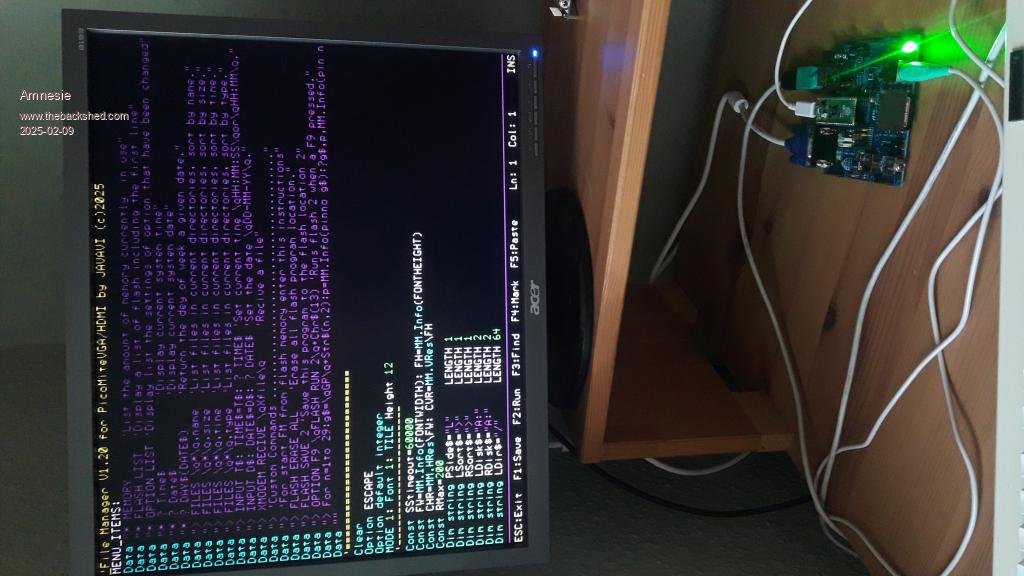

now that the PICO 2 supports higher (double) the resolution of the old PICO in VGA with 16 colours. I converted some pictures and was really pleased with the results, BUT no matter what picture I am choosing for dithering (and in general)
I feel that the C64 colour pallet is far superior to the PicoMite colours.
See for yourself:
Original Image:
Standard colour pallet:
C64 colour pallet:
(Error Diffusion Dithering with Floyd Steinberg)
I am aware of the fact, that the colours are somewhat "hardcoded" via the resistor network. What modification would be needed for a C64 colour pallet? I mean how do you come up with those adapted resistor values (how can I calculate them?)
EDIT: the forum software compresses the pictures (in a nice way) but sadly now you can't really see how bad the original colour-pallet is... In real in looks A LOT more magenta... I prefer the c64 in any case.
I attached a archiv with all three pictures:
pics.zip
Greetings
Daniel
Edited 2025-02-09 20:09 by Amnesie

Hi Amnesie,
Can you check if the color palette of windows95 (the 16 color palette) generates better dithering ?
With the current 4 bits output, that color palette is easy to generate in hardware...but.. you need new names for the colors.
I tried this with a kangaroo picture 2 years ago, and then it looked a bit better. See post of june 22, 2023.
And it included grey...
pico                           VGA
R ------------ 390 -----------+--R
Gmsb --------- 390 --------+-----G
B ------------ 390 -----+--------B
         +--- 820 -----+  |  |
Glsb -----+--- 820 --------+  |
         +--- 820 -----------+
