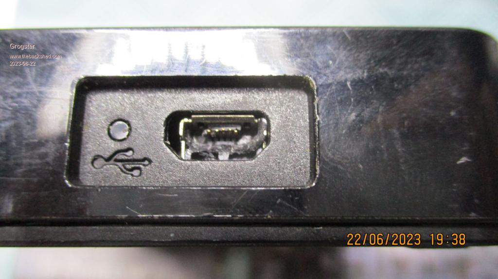

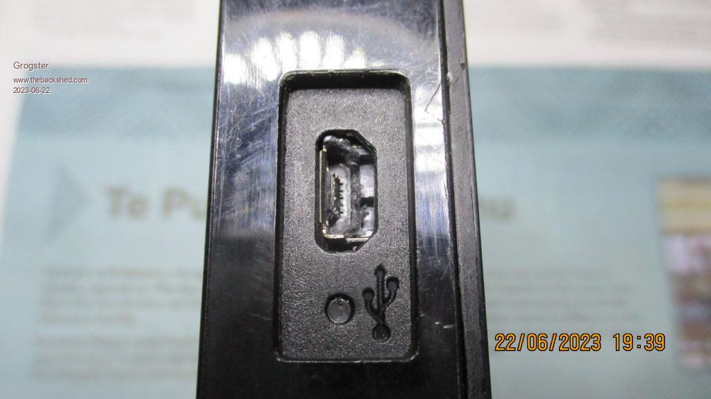

Dear God......
Yeah....just need a new USB cable....
To say nothing of the fact that the socket on this external HDD is TOTALLY munted...

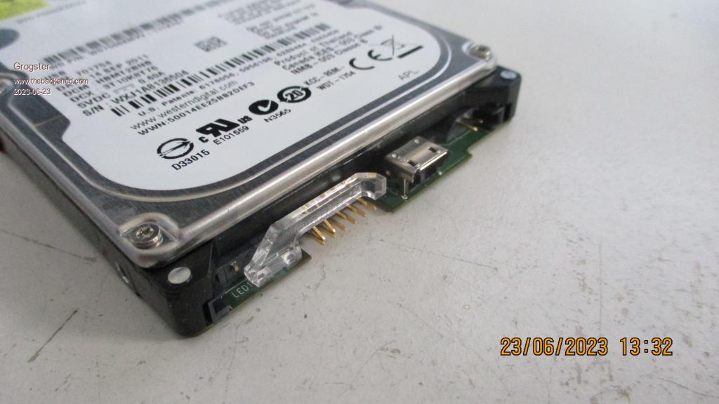

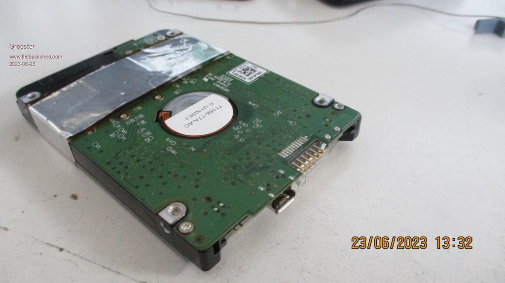

Posts: 9996
Posted: 12:27am 23 Jun 2023
Thanks for all the comments, chums, but this is a WD drive - one of those short ones that is about the same size as a 2.5" HDD, and the USB interface is PART OF THE HDD PCB.  You CANNOT remove the drive, and put it in any other kind of case, you cannot use those SATA to USB adaptor cables - there IS no SATA port to connect to on these drives.
I seem to recall reading somewhere where you CAN solder to certain points on the PCB to get access, but as Mick and others have said, is it really worth it?  Probably not.
It is a 750GB drive, so I guess it depends on how much stuff is on it and of what value it is, to work out if recovery is worth the effort.  At this stage, they think all they need is a new cable.  They won't be prepared for me to tell them the drive is going to be very hard to even use again, cos of how badly damaged the socket on it is.
EDIT: Here are a couple of photos.  Moving to another case or using a SATA cable are impossible on these WD designs.
I have no idea what the dual-row of pins are for, but I seem to recall they are NOT the SATA interface.  I will have a we look around on Mr. Google, cos I know I have seen people hack these drives to get access, but it was years ago.
Note how you can't even access the back of the USB socket, so even soldering a cut-off USB cable to the PCB is not really even possible at first glance.

Posts: 9996
Posted: 03:38am 23 Jun 2023
Excellent idea, Andrew, I will make the attempt.
At the moment, the micro-USB plug won't even slide in there, as the plastic carrying the contacts, is bent hard against the chassis of the socket.
As you say though, I might be able to use a knife to GENTLY bend it back out just a tad.  I only need a fraction of a mm, to be able to get the shell of the micro-USB plug in there, then we MIGHT be able connect to the drive.
I like your glue idea, and if the above works, I would indeed secure the plug permanently in place - and tell them to buy a new external USB HDD and copy everything off this one ASAFP!!!!

Posts: 9996
Posted: 08:30am 23 Jun 2023
IT IS MICRO USB!!!!
The socket on it is so phucked up, you might not have spotted that.
I hate these external HDD's, and WD should know better.
Their INTERNAL drives are fine, cos they adopt standard SATA connectors.  I would never use one of their EXTERNAL USB drives for this reason, cos they are STILL doing it this way for spinning HDD's on USB.
