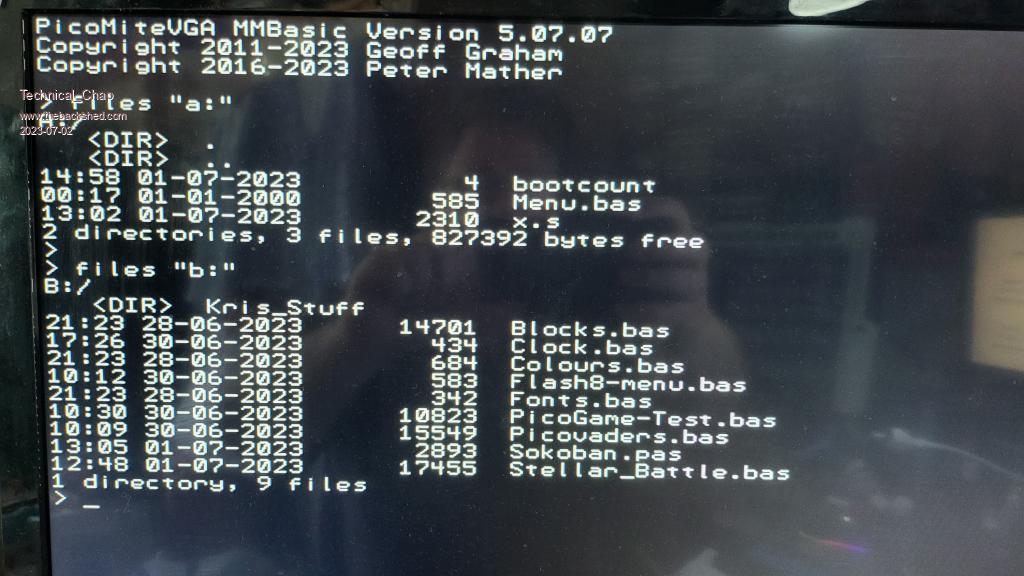

Hello everyone,

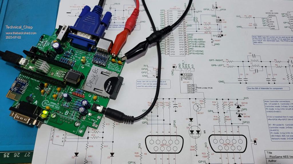

This is my first post so please be kind. I have been putting together a PicoGAME VGA from MAXTEL 90 and I really like the design and features. It worked first time and without problems. It sounds great and plays games well, the real time clock just dropped right in and the SDCard works as it should.
The thing that made me build this version was the WiFi module, I have set it up as COM2 and can sort of get things out of it, but I was thinking that someone might know if there is a programme like Minicom that runs on the picoMite that has been ported to the PicoGAME. This I think would make it much easier to play with.

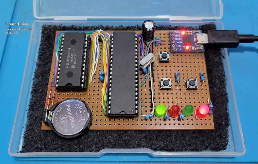

I love building old computers from new (or old) parts.

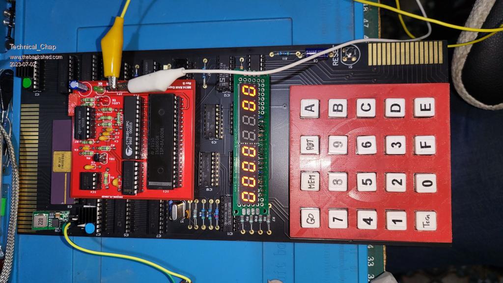

I have attached some pictures and one of Karen Orton's PIC NIBL systems
Thank you..

Hiya! Welcome to the forum. Glad you like the PicoGAME. :)
I'm currently playing with the JDY-40 serial data system and finding it a bit flaky. I don't know why, the digital side works very well indeed. I've had data passing through but getting too many missing characters etc. I'm going to try a different RF channel as I have a feeling that may be a major problem with these boards. They share the same frequencies as 2.4GHz mice, remote controls etc. in a crowded band and there's no automatic error checking going on.
I'm considering rewiring my board to connect the port B digital inputs to the JDY-40 - but all the signals are inverted!
Love the SC/MP build. :) I never played with one of those.

Yes, the SC/MP or PICL 2.0 as it's called. I have a modern MK14 I build a while ago, better keyboard and display, okay I know it's not true to the original, but I love it. I could not afford a real one now days.

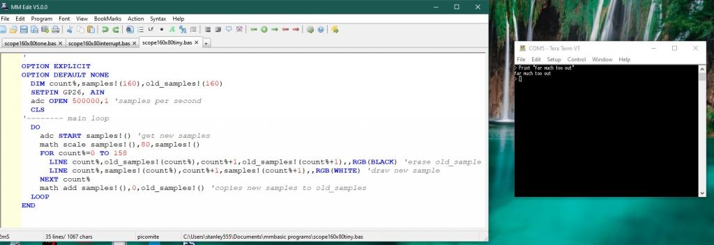

I'm not affiliated to anyone but for aesthetics which way of coding looks today?

You could have used OPTION COLOURCODE ON for the built-in editor at least....  ;)
And you can indent or not as the mood takes you. :)
Print "Press L for a low Left tone"
Print "Press R for a high Right tone"
Print "Press Q to quit"
a=Instr("lLrRqQ",Inkey$)
Select Case a
 Case 1,2
  Play tone 600,0,1000
 Case 3,4
  Play tone 0,1000,1000
 Case 5,6
  Exit
End Select
Print
Editors are very much a personal thing, I think. However, the fact that it's even been possible to fit an editor into the 28-pin Micromite I find amazing. To keep (virtually) the same one for the PicoMite makes a lot of sense to me.

To get back to the original post...  :)
No, as far as I'm aware there is no terminal program for the PicoGAME (yet). I can't see it being too difficult at low baud rates, the difficulty might come in scrolling a reasonable number of lines when you get a LF character. The reason is that the PicoGAME is intended for a VGA display so you are scrolling graphics, not text. I've not tried it, this is only guesswork.
If you want it mainly to work with the JDY-40 then the first thing is to control the CS and SET signals and send AT+ commands to it. I've done this from YAT but I've not attempted it from MMBasic yet.
The JDY=40 will send "Start" on it's TXD pin when powered up and "Wake" when CS is pulled low. That would be a good place to start. The default baud rate is 9600 so sending it "AT+BAUD" at 9600 baud should make it reply with "+BAUD=4". I think MMBasic will include CRLF at the ends of transmitted lines automatically. Once that lot is working we can consider working with text. :)  I have a little transmitter that *seems* to be sending correctly, but reception isn't working properly. In theory you shouldn't need to change anything at all on new JDY-40s, they should just work.
