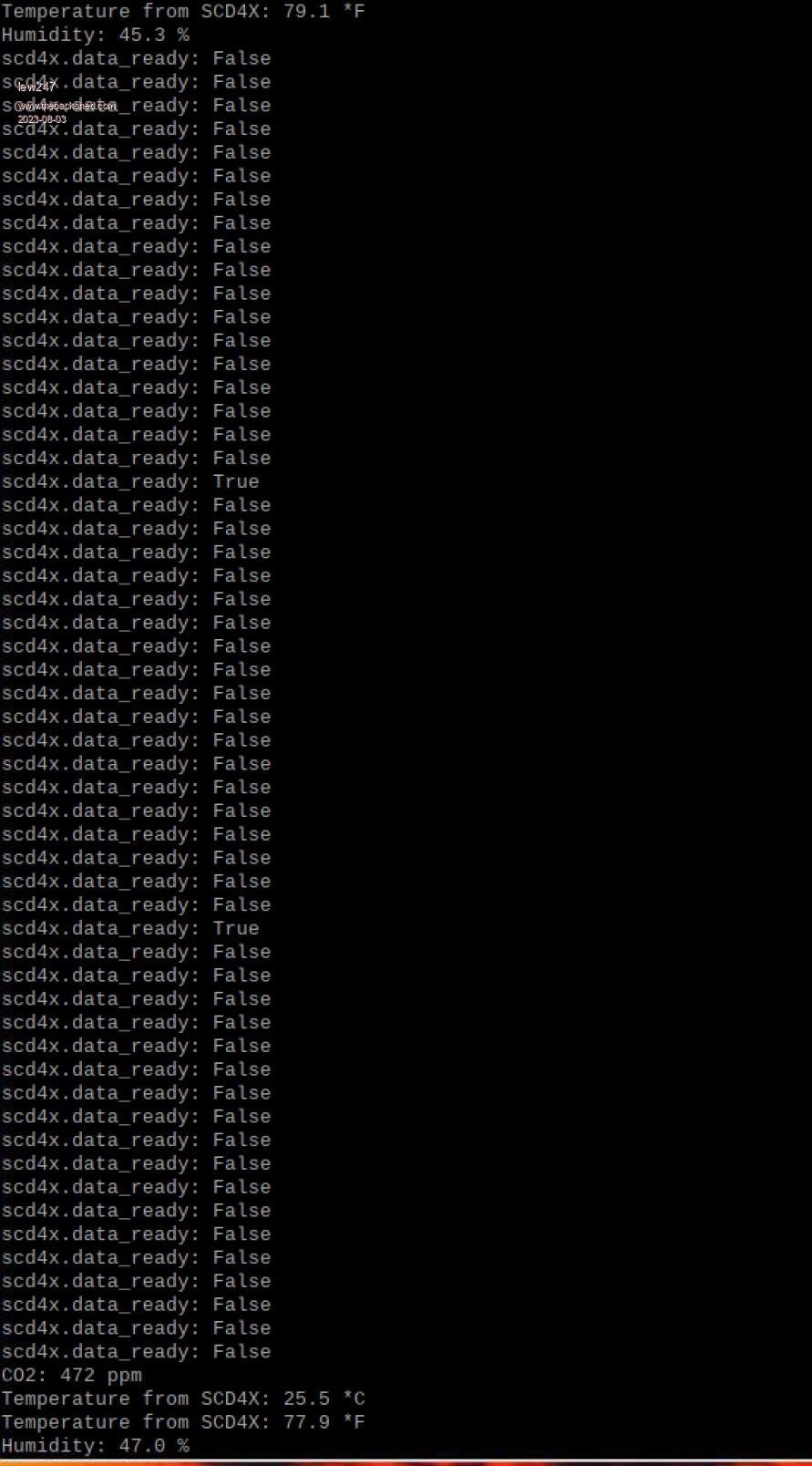

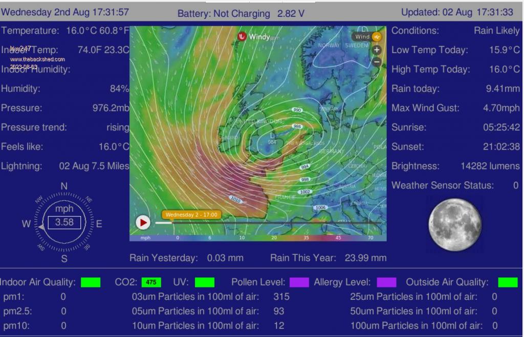

I have this problem
Indoor Humidity only flashes on the screen the goes off again
I know the sensor is working as the CO2 data is displaying
Here is the console output showing the result of print("scd4x.data_ready:", scd4x.data_ready)
How do I get the data to display on the screen but ignore the False, unless there is over 60 seconds of False then it might be a sensor issue
Basically I need a trigger to display the data when the data is true, start a timer ignore any False >= 60 seconds
If any True then the timer restarts
I have spent a total of maybe 18 hours now trying different ways of doing this and even ChatGpt can't help with this because it tried to get me to use a "While True" loop which locks the Pi up
I can't use While True
any suggestions?
   if scd4x.data_ready:
       HumidityScd = scd4x.relative_humidity

   else:
       ren = font.render("Indoor Humidity:", 1, pg.Color(162, 160, 160), pg.Color(25, 25, 112))
       screen.blit(ren, (5, 130))
