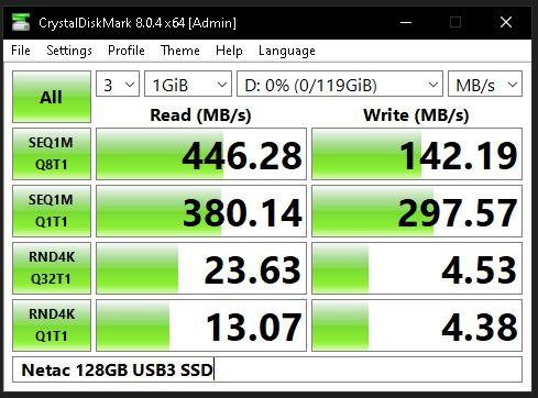

UPDATE: Mint runs happily from a USB flash drive, but even a relatively fast one in terms of WRITE speed(20MB/s) is still not really up to the task.
MANY flash drives with large capacities, do stellar READ speeds, but quite often rather unimpressive WRITE speeds - even the USB3 ones.  They satisfy the USB3 speed on READ, but not during WRITE is what I am saying.
I have ADATA 128GB USB3 flash drives that happily do about 100MB/s in read, but only 10MB/s or so WRITE.
However, I have found a "Real" 128GB SSD in USB3 format for about thirty bucks, so I am going to get one of these and play with BOTH Mint and also Windows using this machine's single USB3 port.
USB3 SSD....
As this is an SSD and not a flash-drive, I am hoping for a good performance boost.
Worth a try for thirty bucks anyway!
Oh, and Quazee137 - thanks for the offer of $$, but I would not impose or suggest the members help with cash.  Sorry if it read that way.  NOT intended.  He can't afford a a NEW laptop, but I can come up with something I think that will still be within his budget - such as a $30 SSD, and I give my setup time for free.
But thanks.
Posts: 9996
Posted: 06:53am 11 Aug 2023
UPDATE: Mint runs very well indeed from the USB3 SSD.  It's almost as fast on boot-up/shutdown, as a standard install.
The USB3 SSD is quite impressive:
Sequential read and write are very good indeed for a USB flash-drive form-factor.
The random read and write are not so good, but we're only talking thirty bucks here...
Still, the fast sequential read/write does result in Mint booting up and running the primary app - firefox browser - very quickly indeed.
Results would be even better I guess, with a "Proper" USB3 external SSD, but possibly not by that much as far as your average user is concerned.
So, I have put several website shortcut icons on the Mint desktop for him.
Just double-click to load that website kind of idea, which is how he had his Windoze install setup before the chip died.
I think we have a winner.
