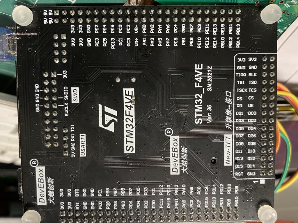

Thanks for that ! I got it going and programmed. Next problem is that plugging in ILI9341 display (also bought AliExpress as recommended as per link) kills the power on the processor board (LED goes out/comms dies)...unplugging re-establishes comms OK. Only tried a couple before realising the serious pinout mis-match. Closer inspection shows all 5 TFT boards I bought have following strange pinout mismatch. Looking at silkscreen on both: Pins TFT Processor 31 32 3V3 GND 3V3 3V3 BAD - SHORT 3V3 to GND !! 29 30 SET GND GND GND sus 27 28 INT BLK TIRQ BLK looks fine 25 26 SI SO TSI TSO also fine .. .. 3 4 DB15 DB14 D15 D14 all fine down to & including this pair 1 2 GND RST RST GND ? maybe permanent reset? Really happy with design of the STM board - no smoke & recovers straight away on removal of short. Can anyone check their pinout to see what a 'good' pinout normally should be? (Trying to paste a picture, I know I have to upload somewhere..but couldn't see instructions where / how) Regards Phil Edited 2023-08-18 21:40 by flip |
