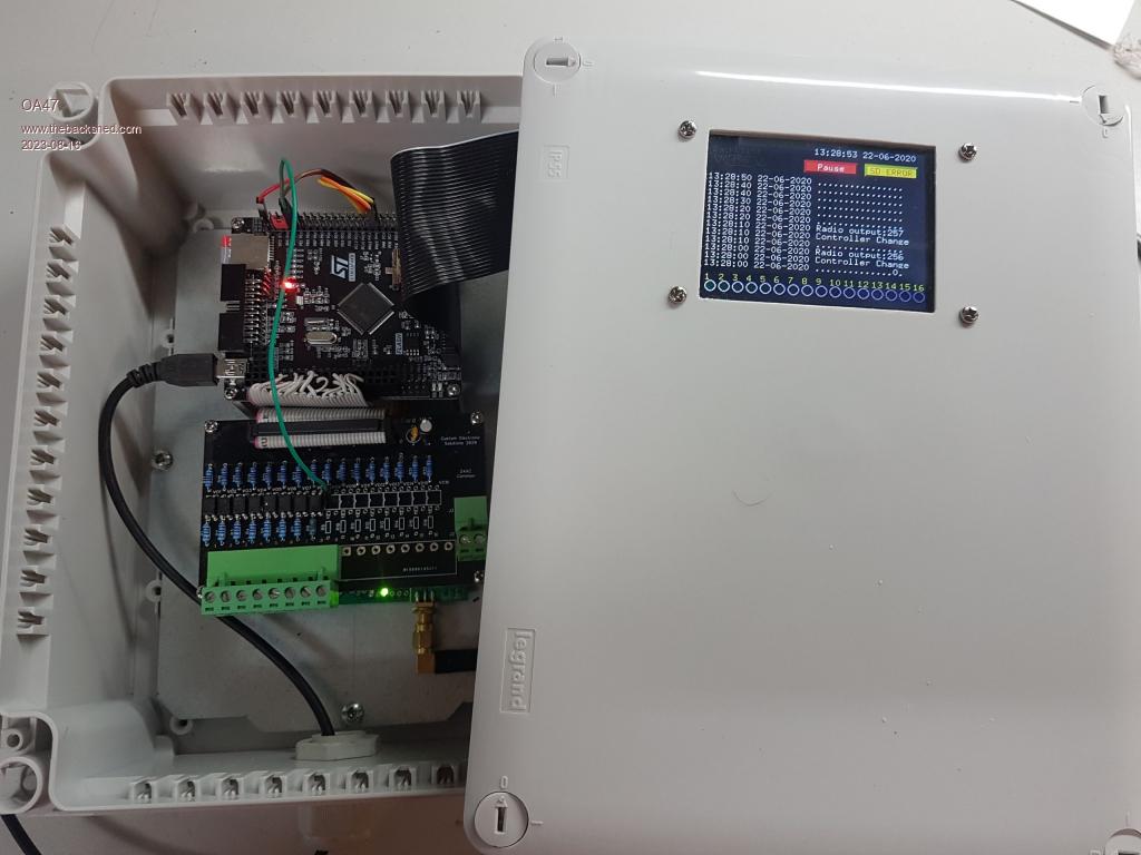

Glen, I have done this before and you cannot use IDC connectors both ends as unlike say a floppy drive or hard drive the pins are reversed on on connector to the other. The only successful way I have been able to accomplish an extension cable is to use an IDC one end and individually solder a header strip to the other end. I will try and find a photo and post it.
Hopefully this helps.
0A47
OA47
Joined: 11/04/2012
Posts: 1050
Posted: 05:12am 16 Aug 2023
Sorry this photo isn't that clear and only shows the IDC end of the black ribbon cable but it does show that it can be done.
0A47
Edited 2023-08-16 15:15 by OA47

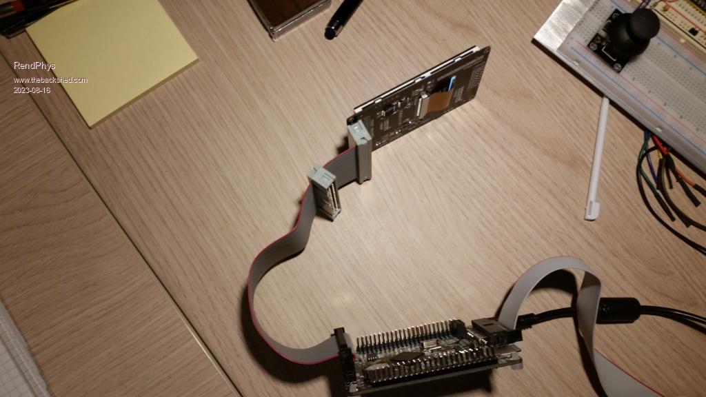

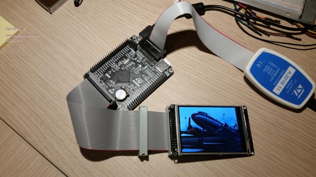

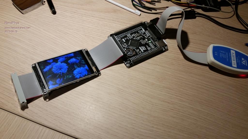

Hi all,
I do indeed use the IDC cables and connectors to position the LCD on any wanted position.
As far as I know there are no 32-pins standard cables, so I use the 34-pins variant. Be aware of the proper positioning of the (unused) pins, so indeed the proper pins are connected. Can be easily verified using an ohm-meter, of course.
Some links to start searching:
https://www.aliexpress.com/item/4001244049708.html?
https://www.aliexpress.com/item/33029492417.html?
Here some pictures of how it can be done...
Best regards,
Henk.

Posted: 12:10pm 16 Aug 2023
Hi All,
As RendPhys, shows they do work as I said.
@Mick,
Have a good look at the crimp IDC female connector before you crimp it, each pin has a Vee shape cutter that cuts into each wire in the cable, it does not matter what side of the cable you crimp it onto pin one of the connector will always go to the same wire in the cable.
The reason, I presume, that some cables are crimped on alternate sides and others on the same side is purely for convenience of plugging into your devices, this will vary depending on physical layout but there is no electrical difference which side of the cable it is crimped to.
