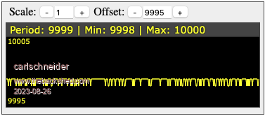

Hi there
I note that currently Pin(GPnn), FIN returns an integer value.
Is this correct or am I missing something?
I'm looking to measure a frequency of 50Hz to at least 3 decimal places.
Any guidance would be appreciated.
Cheers Carl

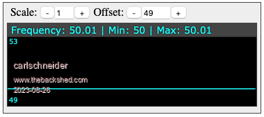

Thanks for the feedback @chopperp and TassyJim.
I have tried longer gate periods but the result is always an integer value, even printing str$(pin(GPnn),6,4).
I have used PULSIN to measure the period and using that to determined the frequency. It measures period in µs.
Sub Freq
TimeEnd=Timer
Period%=Pulsin(GP22,0,25000,25000)
Period2%=Pulsin(GP22,0,25000,25000)
Period3%=Pulsin(GP22,0,25000,25000)
Period%=(Period3%+Period%+Period2%)/3
DeltaTime=TimeEnd-TimeStart
Freq!=(1000000/Period%)/2 ' Measuring PWM 50% duty cycle so two edges
Frequency$=Str$(Freq!,6,2) ' used in the JSON string to talk to the graph
TimeStart=Timer
End Sub
This subroutine is called by a 1s Tick. Interestingly the DeltaTime is rarely 1000ms, usually under.
Frequency to 2 decimal places. Target frequency for the PWM output I'm measuring is 50.01Hz.
Using the Pin(GPNN),FIN would just have been far more elegant:)

Thank you very much Volhout and Peter.
It works!
Much appreciated indeed.
Cheers Carl
