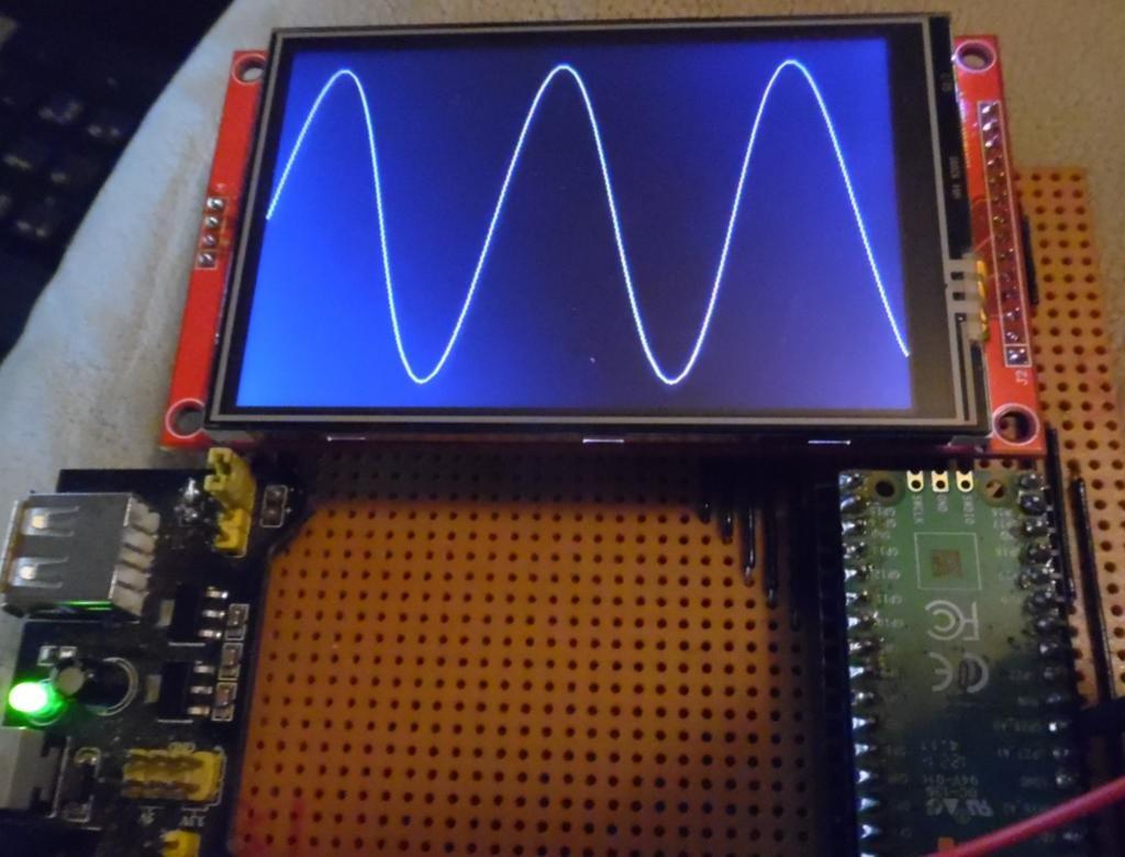

I thought it worth a quick post showing how easy it is to graph data using some of the new bulk data math and memory commands in MMBasic V5.07.08b14
Task plot a sine wave
CLS
' we are going to plot it as a series of line segments not just points
' so create some arrays to hold the coordinates
Dim x1(MM.HRes-1),y1(MM.HRes-1),x2(MM.Hres-1),y2(MM.HRes-1)
' Fill the x1 and y1 arrays
For i=0 To MM.HRes-1
  x1(i)=i ' set the x coordinates
  y1(i)=Sin(Rad(i*2)) 'calculate the sinewave
Next
' now scale the y data to fit nicely in the display
' The display has 0,0 at top left so we want to invert the data and scale it sensibly
' so a sine value of +1 will plot at y=20
' a sine value of -1 will plot at MM.VRES-20
' all calculated in a single simple command
Math window y1(),MM.VRes-20,20,y1()
' We want to plot lines so each line starts a position y1 and ends at y2
' so create the y2 array with each element y2(i ) equal to y1(i-1) and x2(i)=x1(i-1)
Memory copy float Peek(varaddr y1(1)),Peek(varaddr y2(0)),MM.HRes-1
Memory copy float Peek(varaddr x1(1)),Peek(varaddr x2(0)),MM.HRes-1
'deal with the end points
y2(mm.hres-1)=y1(mm.hres-1)
x2(mm.hres-1)=x1(mm.hres-1)
' plot the line segments
Line x1(),y1(),x2(),y2()

Posts: 2807
Posted: 06:03pm 30 Aug 2023
RUN
[18] Math window y1(),MM.VRes-20,20,y1()
Error : Syntax
Posts: 11830
Posted: 06:04pm 30 Aug 2023
  Quote  MMBasic V5.07.08b14
Posts: 2807
Posted: 08:12pm 30 Aug 2023
With MMBasic V5.07.08b14
cool
