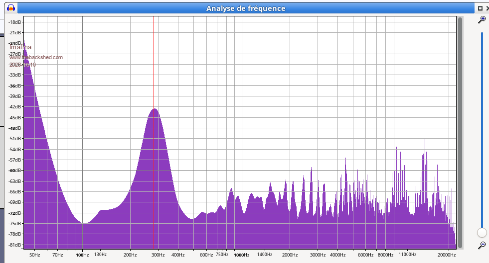

Posted: 06:53am 10 Oct 2023
I still have a lot of troubles with the sound output. I connected my board to a little amplifier module based on a PAM8403, and I get horrible noises. I thought it was an issue with my power supply, but even powered from a PowerBank, I can ear the same noises.
I hooked up my board output to my PC sound card: here too, I can hear noises, but a little bit less. Here is a capture of the analyse from Audacity.
Any idea where the 280Hz noise (and all harmonics) can come from?
Frédéric

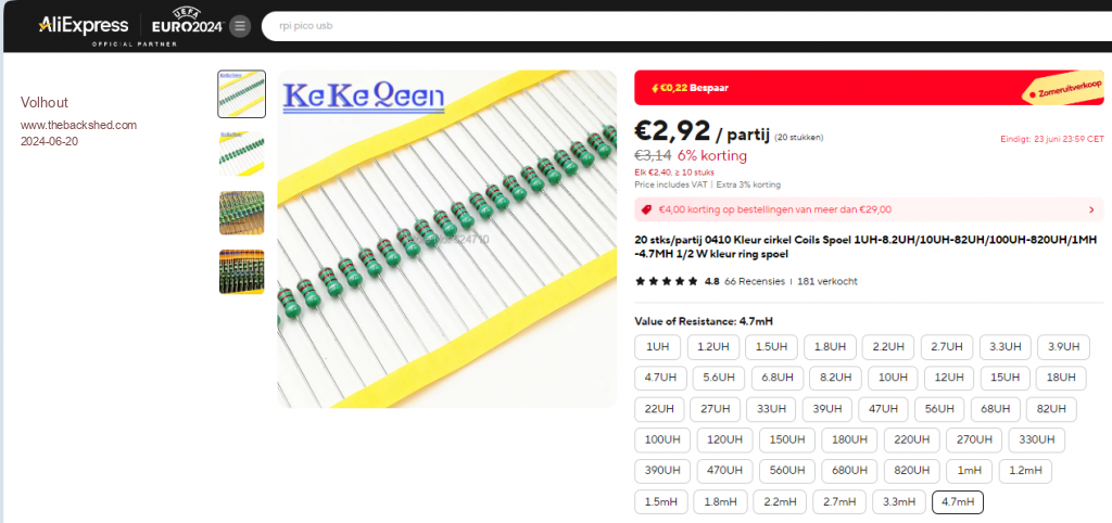

Mmm, I think there is something wrong with my design: I don't have any DC at the output of the filter (as I have a capacitor in serie), but I still have the PWM frequency!!!
Edited 2024-06-20 02:35 by fmafma
Frédéric
fmafma
Joined: 30/06/2023
Location: France
Posts: 31
Posted: 07:33am 20 Jun 2024
What 4.7mH SMD inductor do you suggest?
Frédéric
