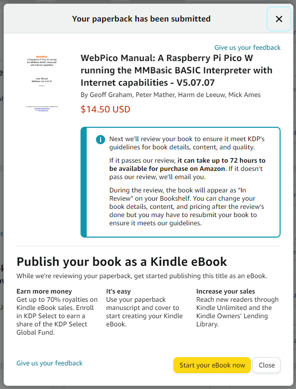

Lizby - The book evidently got pulled by Amazon, perhaps because I listed Peter, Geoff, et. al as authors instead of me. Here's what I see:

I've never had a printed copy of a MMBasic manual, but I'd spring for one at that price if updated for PicoMite 5.07.08.
