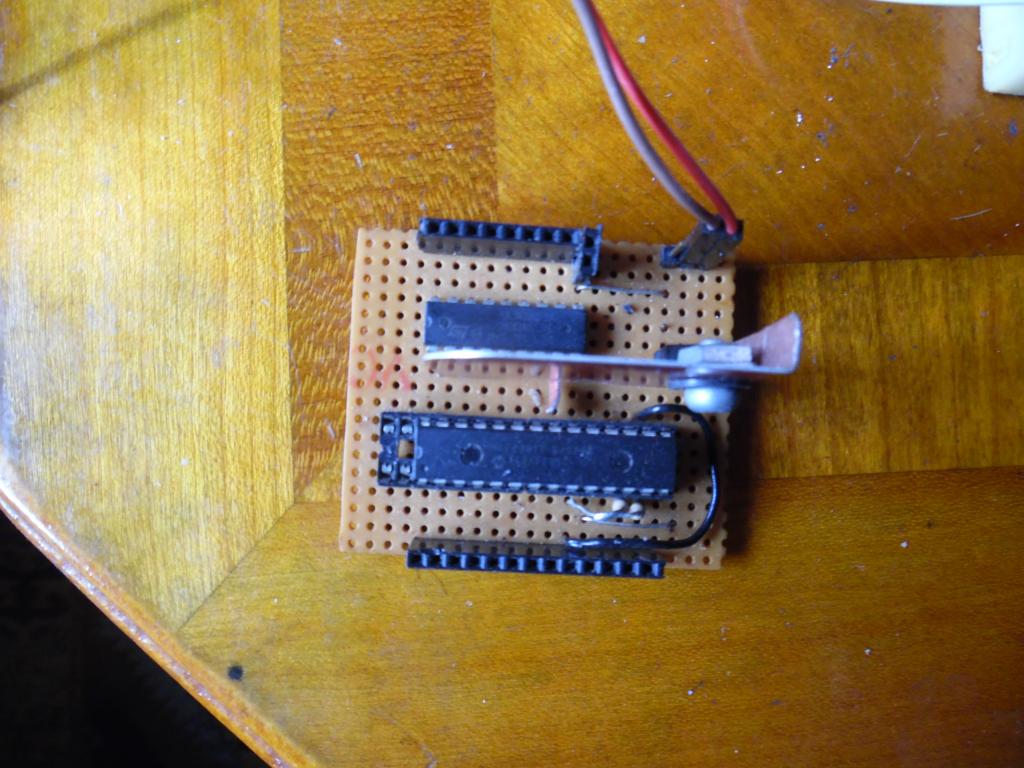

A strip board with a 16 port expander and buttons that I could connect with 4 wire ribbon cable when needed would have been handy so I'm making one.

Thanks lizby. Turns out I bought 5, I found the tube with 2 in. The other is on breadboard, the other in a robot and the other on stripboard ready to replace the one in the robot with dual uln2003 not the boards with leds that come with the motors.

Posts: 2807
Posted: 04:01pm 26 Oct 2023
  Mixtel90 said  If you would like one of my PicX experimenter's PCBs, Stan, send me a PM and we can work something out. Details are in the link in my sig. You might find one useful. :)
That's kind of you to offer Mick but I'm a "vero" guy. stripboard is easy to change and  as a hobbyist it's ephemeral. I don't make permanent circuits
