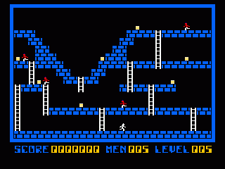

The new layer framebuffer transparency options in the latest PicoMite release candidate (RC12) firmware makes certain tasks very easy to perform.
Here is a quick PicoMiteVGA demo program I've been messing with this weekend. Don't get excited - this only displays levels. There is no game logic or anything else at this stage.
Level Data from the ArduBoy LodeRunner project can, with some massaging, be displayed by my demo code.
Enjoy...

Thanks for sharing. I look forward to trying it. Could you please add a screenshot into this post.

Nice. With IF mm.device$="PicoMiteVGA" then MODE 2, it works on the LCD:

  vegipete said  The new layer framebuffer transparency options in the latest PicoMite release candidate (RC12) firmware makes certain tasks very easy to perform....
What is the nature of the changes?  Does it affect the transparency of SPRITES?
One of my issues with transparency of sprites was that the alpha channel was hard coded to Black…a popular colour for sprites.  If hard coded, I’d prefer it was hot pink…a less used colour.
Posts: 5997
Posted: 06:15am 31 Oct 2023
That is possible now. PETSCII robots uses Magenta as transparent color.
vegipete
Joined: 29/01/2013
Posts: 1182
Posted: 05:18pm 31 Oct 2023
I'm able to use the non-black transparency of the layer frame buffer to iris the playing field into view.
I select a colour other than black as transparent and clear the layer to that colour. Then I draw a black box covering just the playing area. Now I can draw the play field on the main layer, which remains hidden by the black box on the top layer. The play area comes into view as I draw increasing sized circles in the transparent colour on the top layer. Neat!
The closing iris was harder. I wish we had a clipping region for the drawing commands.
