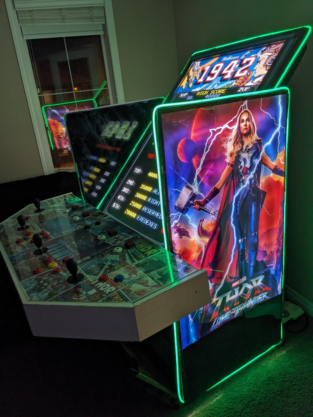

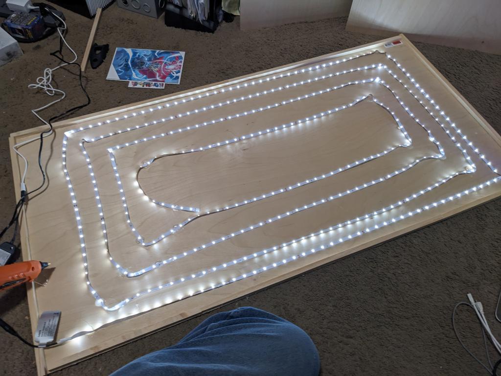

Having been left unsupervised for a week, I've been tinkering, and I thought you guys might appreciate it.

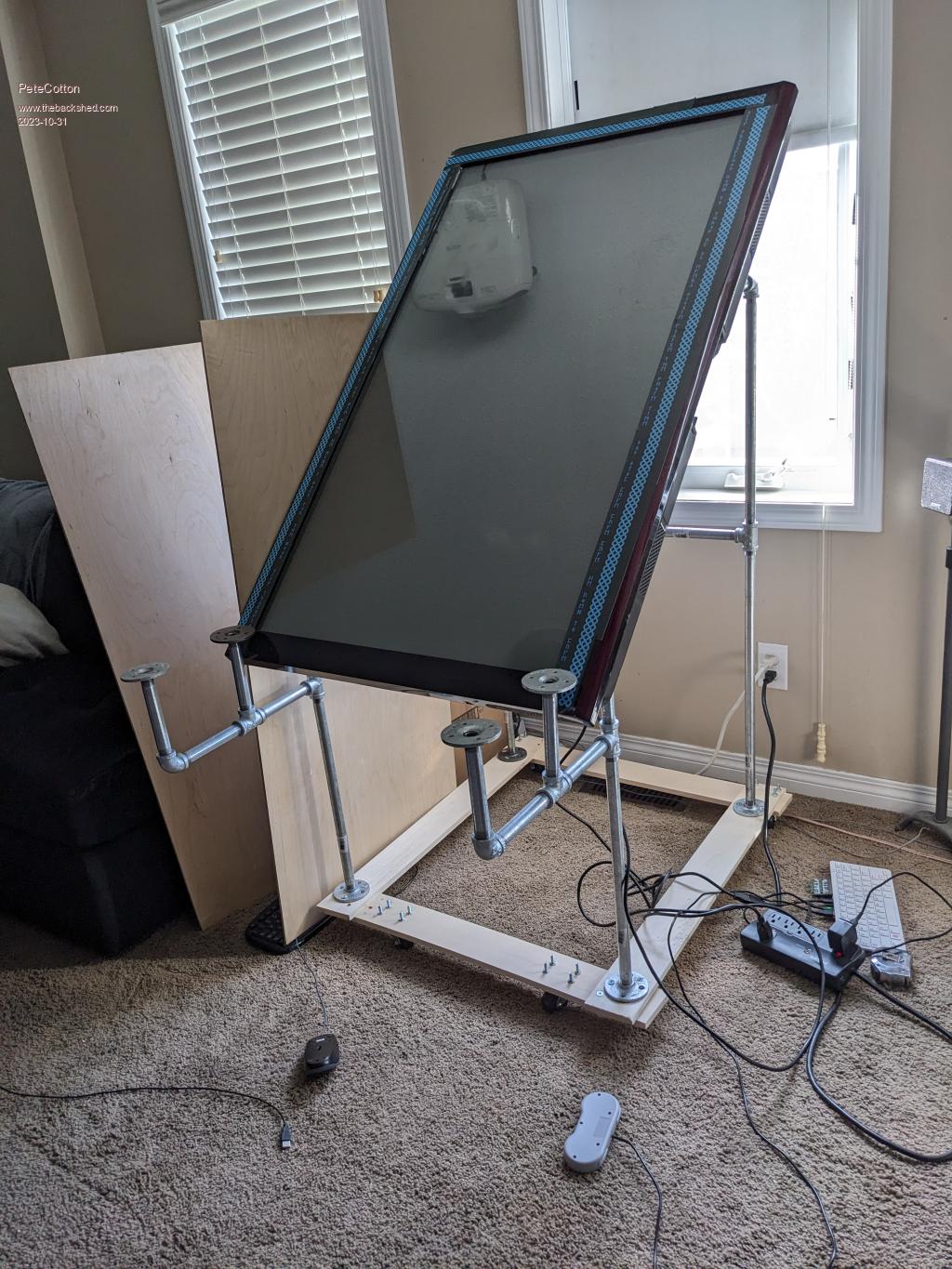

As many of you know, I've always been a bit of an arcade buff, building cabinets and the like. I got the idea of using 1/2" steel pipe to make the frame of a cabinet - so that it would be light and rigid. I also re-used a really old (and heavy) 55" plasma TV that's been languishing in our basement.
Then to make a couple of back lit side panels using extra bright LEDs.

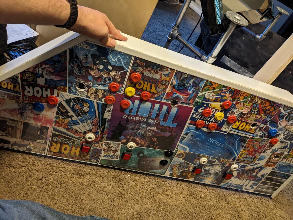

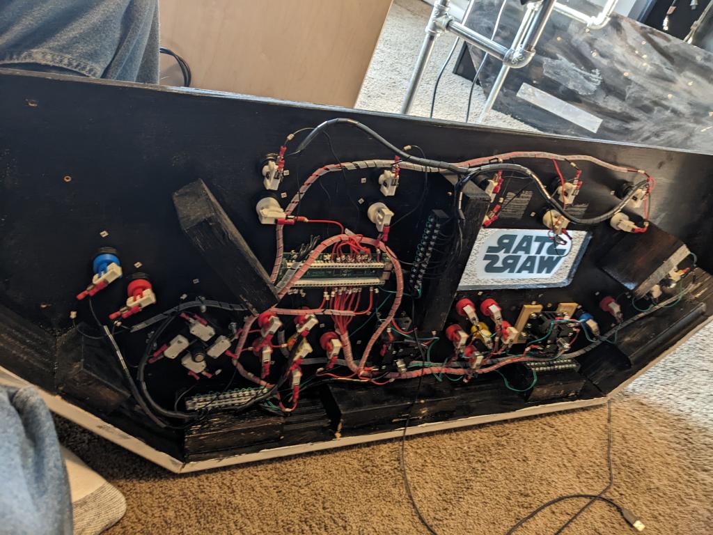

And then re-wiring an old control panel I built years ago. This has an Ultimarc I-PAC 4 keyboard encoder at the heart of it. It's a bit long in the tooth now, but still works great. Takes a bunch of digital inputs and converts them to USB keypresses.
https://cdn.shopify.com/s/files/1/0008/4262/9179/files/I-PAC_4_Player_Card_Wiring_Diagram.pdf?v=1600300277
The old control cabinet was Star Wars themed - so I refreshed it with a Thor based theme by buying a bunch of Thor Comic PDF's online and printing out the frames that I wanted.
Edited 2023-10-31 06:50 by PeteCotton

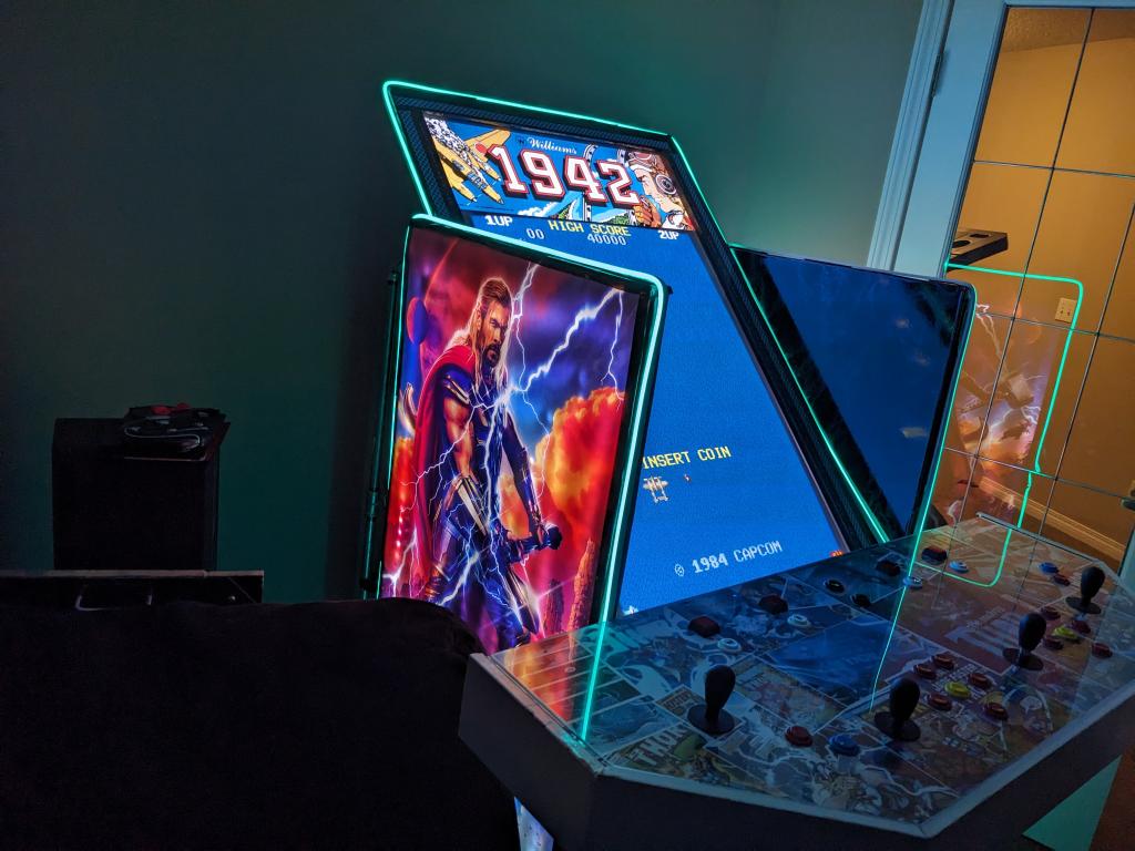

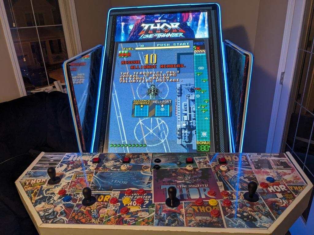

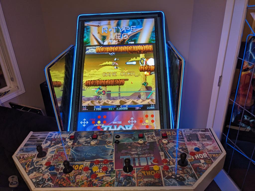

I put a Raspberry Pi 400 in as the brains, and bought some original Thor movie posters (printed both sides) for the side panels and here is the end result.

I've always thought the CMM2 would make an excellent arcade mainboard. I might try and hook it up to the I-PAC and see if I can get it doing something funky.
