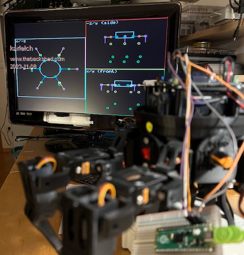

Hi,
I work on a program to control a 3-DOF 6 legged robot. This means to make heavy use of the MATH functions. What I am missing are functions to add or multiply arrays. Something like "MATH ADD v2, v1", with v1 and v2 being 1-dimensional arrays and, for instance, v2=v2+v1. Something similar would be useful multiplying the individual elements of two 1-D arrays. Or is there some functionality that I missed?
Thanks!
karlelch
Joined: 30/10/2014
Posts: 354
Posted: 06:19pm 07 Nov 2023
P.S.: For illustration, I am using PicoMiteVGA running on matherp's v1.0a board (great!) to graphically debug the robot software

Mine is also already a long-term project. I had it running but was not happy with it's response time - it was very sluggish. Therefore, I want to make another attempt ...
https://www.youtube.com/watch?v=Nta-bDtqCa4

It uses some simplified inverse kinematics. I derived the code from an example implementation. If you mean by force feedback sensing servo load: yes, I implemented that for a subset of the servo channels. But this sensor information is not yet used.
