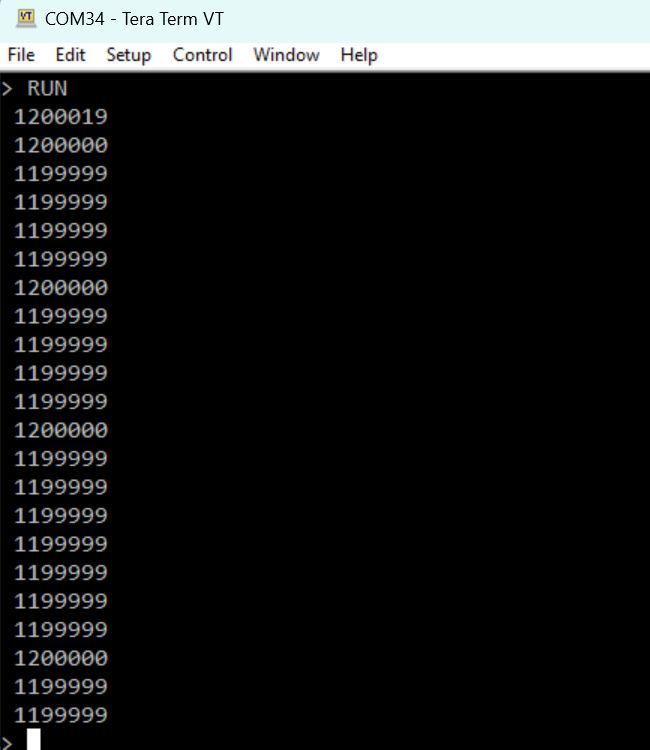

The COUNT function uses interrupts and will easily do what you want. Count pins are automatically set up with hysteresis to avoid noise.
Easily proven. Connect GP0 to GP8.
SETPIN GP0,pwm
setpin gp8,cin
pwm 0,20000,60
settick 60000,myint
do
loop
sub myint
a%=pin(gp8)
pin(gp8)=0
print a%
end sub
Edited 2023-11-09 20:18 by matherp

The count happens totally transparently in the background under H/W interrupt control
I am setting a PWM pulse to output on GP0 at a rate of 20000Hz to mimic your application and connecting that pin to GP8 which I've set up as a counting pin
I'm then setting a Basic interrupt to fire every 60000mSec (1 minute)
In that interrupt I read the current count and reset it to 0 and then print the value
- easy
