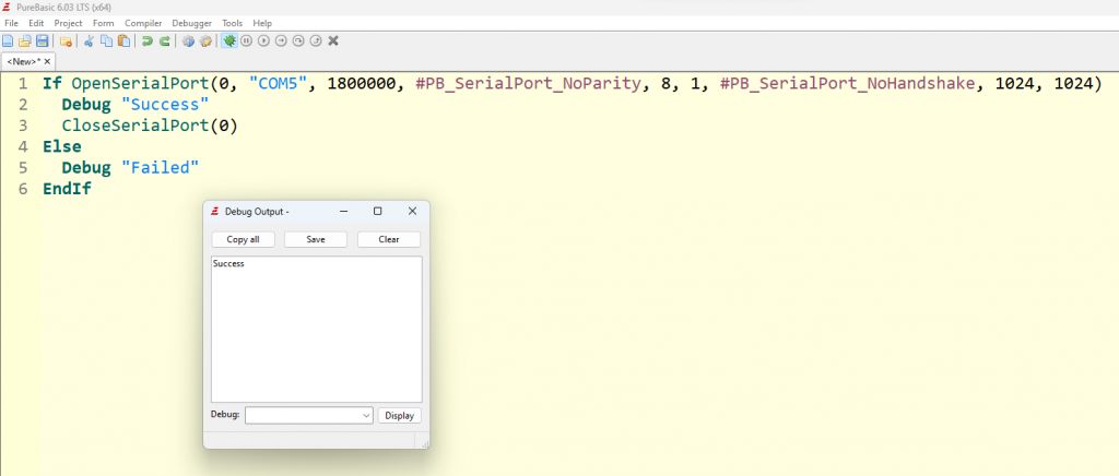

@TassyJim
This was a nice surprise because the doc's state a maximum of 115K Baud.
If I can figure-out reading/writing to the port (nothing like other Basics), maybe I can talk to the Armmite H7.
Posts: 6603
Posted: 08:54am 10 Nov 2023
The maximum baudrate will depend on the serial port make and version.
Some require you to stick to the 'standard' rates.
Some let you use various tricks to achieve non-standard rates.
And then there are some like the CH340 clones/fakes that can be tricked into life by starting with a low baud rate then changing to a higher rate once opened.
To keep things more reliable, MMEdit sticks to the 'standard' rates
