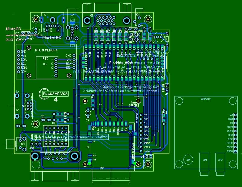

PicoGAME 3 sank in a sea of apathy (and because I ran out of money!) so here's the beginnings of another attempt.
Same box because I like it.
Single DB9 and a standard size SD card socket on the front.
CP 48x2 audio
Optional PAM amplifier, but you'll need to fit a volume knob on the front.
No RTC this time as I've run out of I2C ports.
PCB designed to accept surface mount Pico or sockets for Pico or YD-RP2040
In theory it can be put into the case without having cutouts in the sides apart from a small hole for the Reset button.
Purely optional side entry position for the power connection.
I'm not anticipating powering the Pico from its USB all the time, although it can be done if there's no case.
DB9 connections:
1 - Latch2         IC2 SCL   GP15
2 - Data           I2C SDA   GP12
3 - Latch1         I2C2 SDA  GP14
4 - Clock          I2C SCL   GP13
5 - ADC0           Direct connection
6 - VCC            Controller supply voltage
7 - /LV            VCC= approx 4.5V when open, 3V1 when low
8 - GND
9 - /ADAP (ADC1)   Via 470R
Design aims to get as much versatility as possible. To this end an external adapter PCB can be plugged in to get two controllers if required.
The general idea is that, on initialisation, Latch1 and Latch2 are set high. A I2C message is sent on I2C1. If there is no response then a NES or SNES controller is assumed. /ADAP can then be tested. If it is low then there are two controllers connected.
If a response to the I2C message is received then it may be a Wii controller. A custom I2C flash ROM could be used to identify other devices. Once again, /ADAP can indicate one or two controllers. In the case of I2C the two Latch lines become I2C2 for the second controller (all Wii controllers have the same fixed address (0x52), I'm told).
Additionally, up to two "paddle" controllers can be used. One uses ADC0 and two of the digital inputs for buttons, the other uses /ADAP (ADC1) and the other two buttons./LV must be low to limit the input voltage to 3V3.
Note that any Wii controllers will always need an adapter as they need to connect /LV to GND to get a 3v3 supply. The NES and SNES controllers use 5V.as level shifters are incorporated.
Still at the ideas stage, but I've done an early PCB drawing to see if things will fit. :)

I drew the circuit yesterday but then had an idea... should I incorporate the VS1053 module instead of the MCP48x2 chip? To do that there would be compromises, I think:
If a plug-in Pico or a YD-RP2040 was to be used then a microSD card would be needed.
To keep the full size SD a surface mounted Pico would have to be used.
Personally I rather like the idea. I would like to be able to keep a plug-in Pico module though - without going over a 100x100 PCB. It might be worth the effort.

Posted: 09:53pm 20 Nov 2023
Yes, it fits. :)
Same PCB size and case.
VS1053 audio
Optional PAM8403 stereo amplifier (you need to sort out your own sockets & volume control)
Standard size SD card socket
Single DB9 controller socket
Handles one WII controller or one NES/SNES controllers
RTC
Plug-in Pico or YD-RP2040 or a surface-mounted Pico

Obviously some sort of adapter is needed for a WII controller. There is no PCB space for a socket.
An adapter is needed if two NES/SNES controllers are used. They have separate Latch signals.
Latch1 and Latch2 are ADC inputs so, in theory, a X-Y analogue joystick or two paddles with two buttons each could be used, but detection isn't automatic.
Edited 2023-11-21 07:59 by Mixtel90

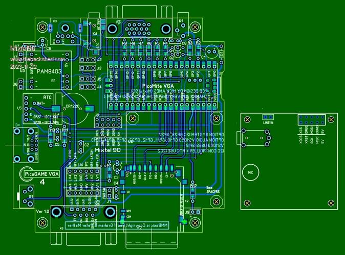

Posts: 8971
Posted: 10:29am 22 Nov 2023
There's a layout now. Circuit not quite right at the moment.
I've squeezed a WII controller socket in on the LH side but it's dimensions are intelligent guesswork as I can't find a drawing and I've not got a controller or a socket. The enclosure wall may be too thick, requiring quite a large cutout. The I2C connections appear on the D9 connector as well as here.
The VLS1053 is connected using a female-female Dupont loom or something similar. Audio can come from the jack or from wires tacked on underneath. They connect to either J2 (direct output) or J3 (via volume control to PAM8403). A volume control pair can be plugged into J4 and J5 but I'm not sure where you could mount it. The VLS1053 is mounted on 5mm spacers but only 3 can be used as one corner is over the top of the SD card socket.
Resistors can be either through-hole or 0603. The Pico can be surface mounted or plug-in. A YD-RP2040 can be used instead.
When the RTC battery goes flat take it off, connect the BAT+ wire to it and fit a CR1220. :)
GP26 was left so I connected it, via R12, to a socket near the front for an LED mounted in an awkward spot over the fixing screw. :).

Posts: 5998
Posted: 08:24am 23 Nov 2023
Why not place the VLS1053 connector such that you can plug the board directly on top?
(upside down), preferably so that the audio connector and SD card and controller interface connector are in the front panel.
Edited 2023-11-23 18:25 by Volhout
Posts: 8971
Posted: 08:47am 23 Nov 2023
I seriously considered that, and I think I could do it. However, I've not got one and I can't find a drawing that gives the connector position (or anything other than the overall size). There's no chance of getting stuff on the front panel unless I get rid of the D9 connector. I could get the WII connector next to it, or a 6P6C RJ. TBH I wouldn't mind doing that. ;)
Posts: 11660
Posted: 08:52am 23 Nov 2023
There is the other  version of the VS1053 which is available at a good price and has an "easier" header. It has a SDcard on the bottom which we can't use as it connects to the same SPI as the VS1053 but it can be ignored
Posts: 8971
Posted: 09:30am 23 Nov 2023
Thanks Peter, I'll try that. It looks as though it might be easier. No-one seems to give even an overall size though. lol
EDIT:
It looks like this one will fit. Jack sockets on the front. Took the amp and stuff out as it's no longer needed - this seems to drive headphones or a line out. Managed to keep the D9 connector on the front too.
I'm assuming that the CS pin will be for the SD card, so not connecting that. You can't get to it anyway.
Incidentally this is how I got the size:
Grab the largest photo off the web.
Convert to JPG.
Insert into NanoCAD as a raster image.
Trace over it, putting a line between the positions of the end terminals.
Draw a precise line of 22.86mm (9x25.4)
Scale the tracing by reference so that the line between the terminal ends matches the reference line length. The board size is now scaled to full size (well, as accurate as the photo).
Measure the scaled tracing and convert it to a Makro for SL6.
Edited 2023-11-24 01:10 by Mixtel90
