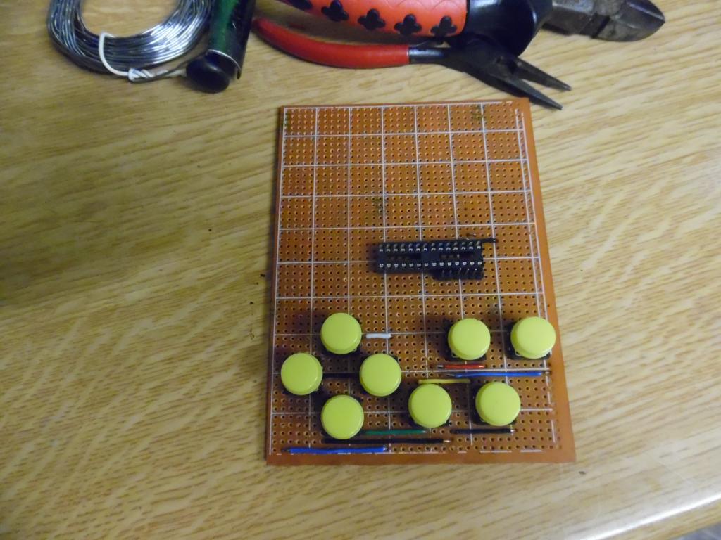

I built a mcp23017 expander and wired all the buttons 90 degrees the wrong way. Please form an orderly queue to kick some sense.

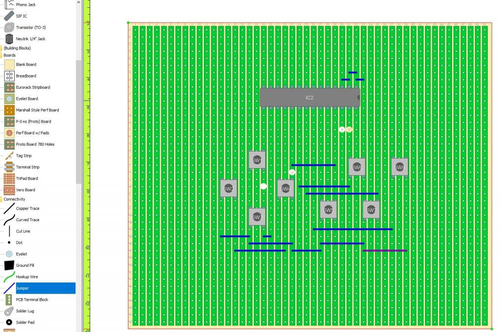

I wondered why the buttons didn't fit stripboard designer progs. doh.
anyone else mess up stupid?

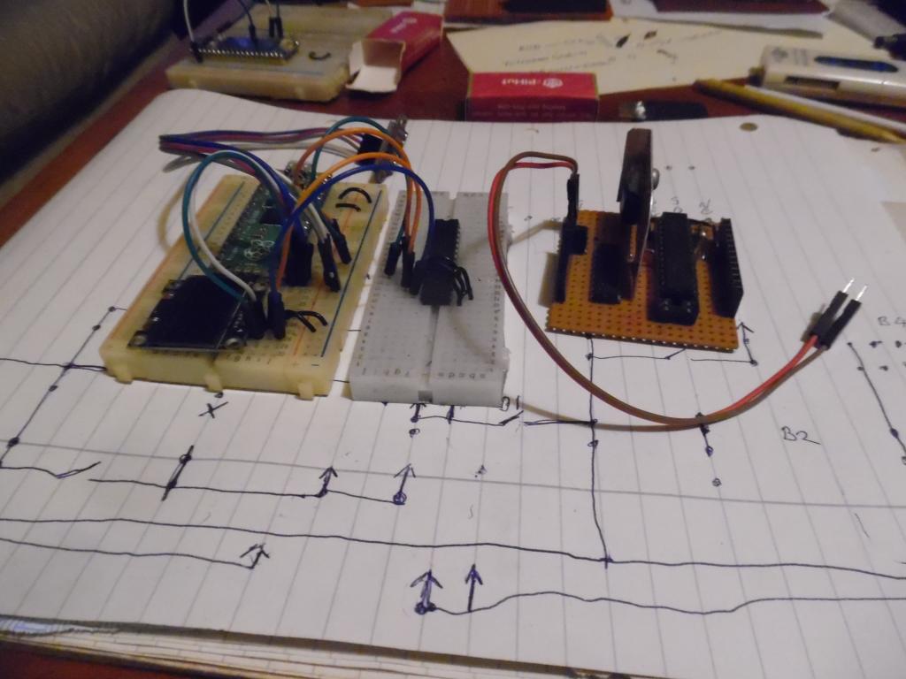

I think the vga keyboard that is 2 wires I should try with lcd. mcp23017 total rewire.I'm thick. thought it be a nice in-out board I'll try again.

I've messed up those tact switches often enough that I make sure I always wire them up on diagonally opposite corners. Then the 90 degrees doesn't matter.

Using DiyLayoutCreator and like vcad, the buttons align if the right way round.
I don't know about placing buttons diagonally??

got a tube of 5 16bit expanders and only used for output so will test input pullups.
nice chip.

  stanleyella said  I don't know about placing buttons diagonally??
Buttons aren't placed diagonally--diagonally opposite pins are connected, making sure that you cannot be connecting to two pins which are already internally connected.

  vegipete said  I've messed up those tact switches often enough that I make sure I always wire them up on diagonally opposite corners. Then the 90 degrees doesn't matter.
That is exactly the approach I have used for years and indeed I used in the layout of the Game★Mite PCB.
Expanding on Vegipete’s description the trick is to wire the 2 connections on diagonally opposed pins as then no matter which way the switch is plonked into the PCB the switch will always be ‘correct’ way around.
