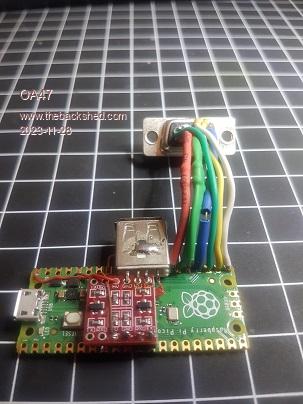

Here is my minimum parts build Pi Pico VGA.
I can double sided tape it to the back of the monitor. I have chosen a monitor that has a USB port and the USB keyboard supports PS2 connection.

Wow, so small!!!
It makes the RPi Pico look like a giant.

  Quote  Wow, so small!!!
Geoff, I presume you are talking about the level shifter board and I am only using half of it.

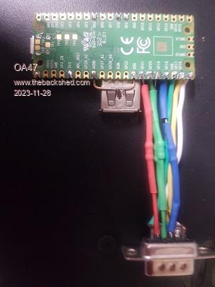

What's on the underside of the Pico board?

  Quote  What's on the underside of the Pico board?

Oh - the resistors are inline with the wires. Sorry, I didn't see that initially.

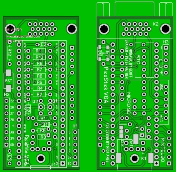

I did a PicoStick some time ago. I cheated and used a PCB though. :)

I have built a couple of Mick's PicoSticks that work great!
