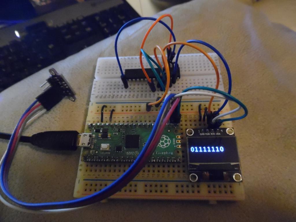

I2C write MCP23017,0,1,GPIOA
I2C read MCP23017,0,1,portabits
text 0,20,bin$(portabits,8)
Pause 100
Thanks but doesn't read the bit grounded but sometimes shows 11111111 which if pullups work makes sense. but mind of its own. it could be chip setup for addressing ??

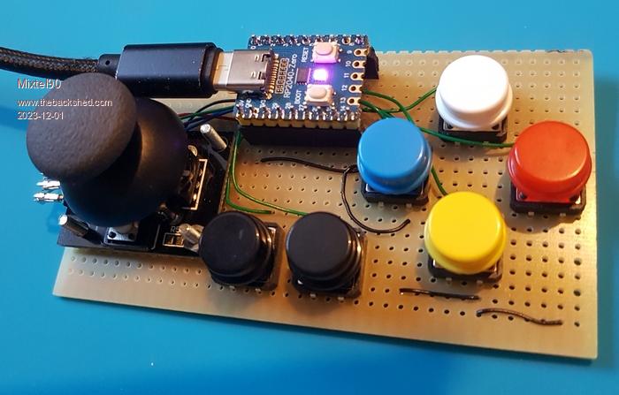

I've been using a RP2040-Zero as an I2C expander for a controller (I'm just doing a hardware prototype at the moment). It has a lot of advantages. I can program a cheap analogue joystick module as either analogue X-Y or as digital by using the PicoMite as comparators. I can also change the I2C address under software control! :) Pretty cheap from AE too.

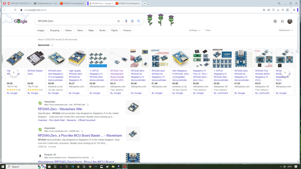

Posted: 08:52pm 30 Nov 2023
  Mixtel90 said  I've been using a RP2040-Zero as an I2C expander for a controller (I'm just doing a hardware prototype at the moment). It has a lot of advantages. I can program a cheap analogue joystick module as either analogue X-Y or as digital by using the PicoMite as comparators. I can also change the I2C address under software control! :) Pretty cheap from AE too.
https://www.aliexpress.com/item/1005005533904456.html?

Posts: 8971
Posted: 10:17pm 30 Nov 2023
This style Stan.

Mick.. rpizero as expander.. interesting idea for versatile in/out,
Posts: 2807
Posted: 10:48pm 30 Nov 2023
  Mixtel90 said  This style Stan.
can it be progged with mmbasic and any info? ae argh login.. ebay, I'll check.
will it be more difficult than mcp23017.. if that's possible?
I like the idea of i2c expanders and at a good price a rpizero...what ever that is.
If you think an i2c expander useful and rpizero for £1.50 then useful for others..
lib type commands like it's in the manual. If it's spi then complicates using ili lcd but i2c better.
Edited 2023-12-01 10:16 by stanleyella
Posts: 2807
Posted: 12:35am 01 Dec 2023
Rpizero as expander, price ok but someone got to sort it as an expander, don't that mean code it. herder than 23017 :)
