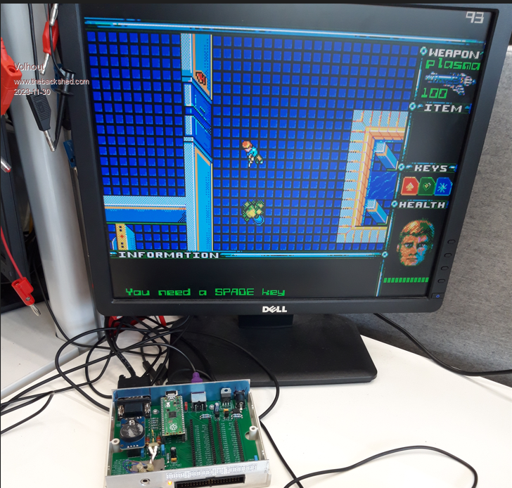

All,
The development of the PETSCII ROBOTS game (original designer David Murray aka The 8-bit guy) for MMBasic for the PicoMite is in beta phase.
The game should have all game elements implemented. In this phase we are looking for testers. People who want to play the game, and report problems with functionality of compatibility.
Attached in this post are
- the original game manual
- the game itself
- picomite firmware versions for picomite and picomiteVGA (V050708RC21)
The game will run on:
- Picomite VGA platforms, using keyboard control
- Game*Mite platform (LCD), using the 8 buttons for playing. You must start the game using the keyboard though, since it is not autorun becuase you replaced the GameMite firmware.
- PicoGameVGA platform, using either keyboard or NES controller.
Install
- install the required firmware (.uf2 file) on the picomite (unzip the ZIP first)
- Unzip the game "petrobot25d" to an SD card
Setup
You need to enable the MOD buffer, and run the pico at 252MHz.
The game must be run from an SD card
OPTION SDCARD your_specific_GPIO_pins
OPTION MODBUFF ENABLE
OPTION CPUSPEED 252000
B:
CHDIR "petrobot25d"
RUN "pet25d.bas"
You can use the attached user manual to get fammiliar with the game mechanics.
This game is partly a shooter, and partly a puzzle game (you can never win if you just shoot every robot you encounter).
Read the manual before playing the game, it enlightens, and explains the keyboard controls.
Happy gaming, and let's hear your comments....

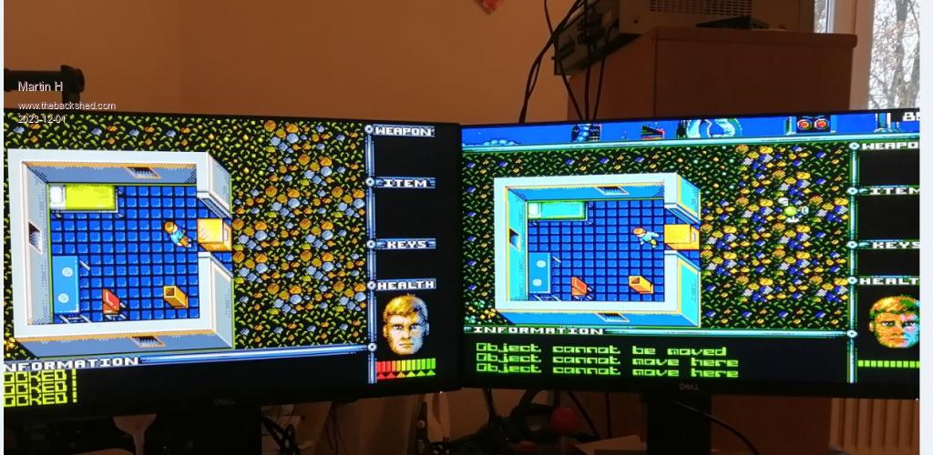

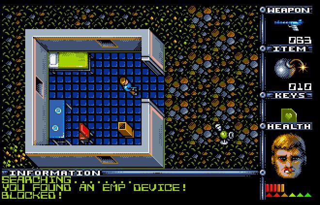

I thought I had found another bug.
You can block your own path by placing boxes in external doors but the same thing happens in the Dos version.
so its not a bug
but There's a slight difference:
In the Dos version, objects in the direct area of the bomb can be destroyed. and you can move on
on Pico they just open and you are stuck .. esc to end the Game

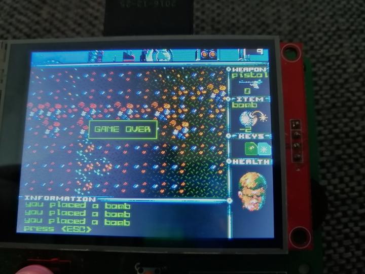

another special feature in the gameplay...
somehow you can have a negative number of Timebombs (and use them)..

Posted: 09:56am 02 Dec 2023
Thans Martin,
I will look at these. Both should be easy to fix. I assume the plasma gun would also destroy boxes.

  Volhout said   I assume the plasma gun would also destroy boxes.
I checked it in the DOS Version.
Looks like Plasma gun does not, unless a Canister is near the Box which explosion also  destroys the box.
another little different, in DOS Version you can not place a bomb direct on top of the Bot, in the Pico Version you can. (I don't know if that makes a huge difference in gameplay).
My  strategy is to walk towards the hoverbot until it's sandwiched between me and the wall(or other turning point), then drop a bomb on it and move 3 steps away from him in the direction he is walking.The Bomb would kill the Hoverbot but dont hurt you
This works also in Dos version, but there you have to leave a space between you and the Bot and place the Bomb there.

All,
I have taken Tom's version, and fixed the bugs that Martin mentioned.
The Timebomb now can destroy virtually all objects, where as the plasma gun can not.
You cannot use more bombs and magnets than you have.
I left the option open to put a bomb on top of a bot. I like it...
