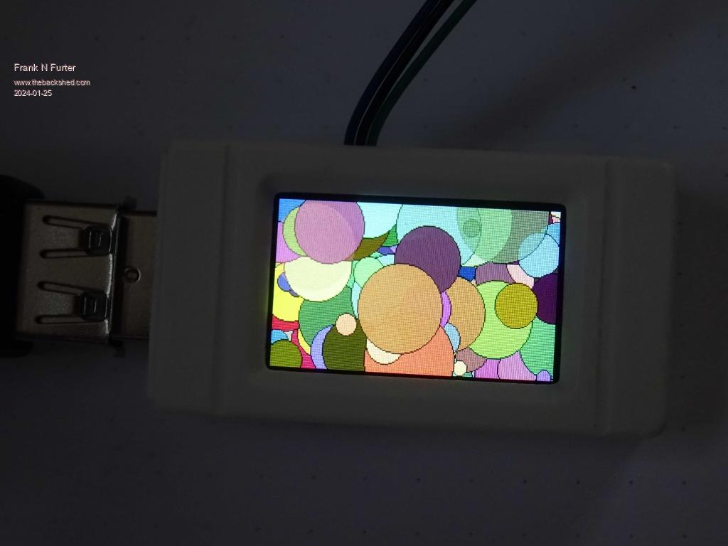

@Bernie3D:
Thank you for pointing out this beautiful board! It really works fantastically!
These are my settings:
OPTION HEARTBEAT OFF
OPTION PICO OFF
OPTION SYSTEM SPI GP10,GP11,GP28
OPTION LCDPANEL ST7789_135, LANDSCAPE,GP8,GP12,GP9,GP25
OPTION SDCARD GP23, GP18, GP19, GP20
OPTION AUDIO GP2,GP3', ON PWM CHANNEL 1
It is possible to connect COM2, PWM2 or I2C1 to the UART socket.
I2C2 or PWM1 can be connected to the DEBUG socket.
With the I2C/ADC socket, GP29 should be able to be used as ADC3 (not tried) - GP28 is already used for SPI MISO and therefore probably cannot be used...

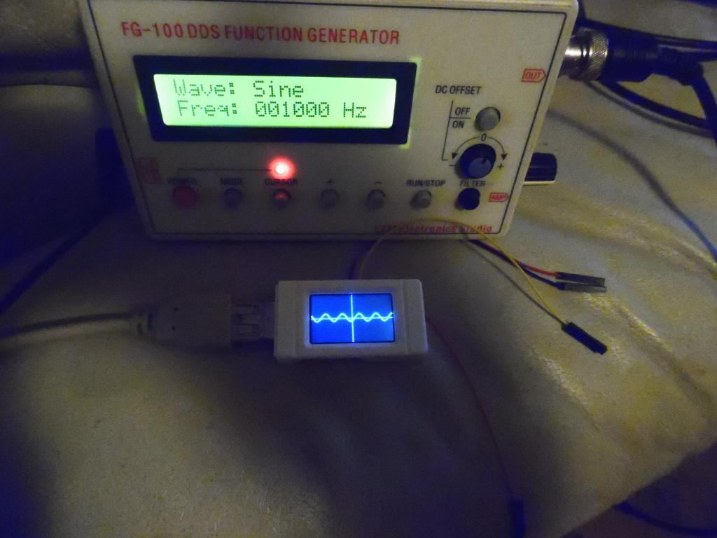

Posted: 02:34am 26 Jan 2024
I've just ordered two, and will port the oscilloscope code to them when they arrive, post the code on my Github site, then post a link here.
- Steve ("NPHighview")

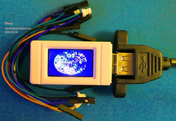

Posted: 05:13pm 05 Feb 2024
I just received two of the Waveshare RP2040-Geek boards. Originally, I was concerned that I wouldn't be able to find connectors for the three ports on the side of the enclosure, but they're included, with female-terminated wires (with GND:black, 3.3V:red, and signals blue, green, orange, and yellow). It's pretty easy to figure out which is which.
The little enclosures snap apart readily, but the Reset button cover sproings out - keep an eye on it :-)
Volhout's recommended OPTION configuration works wonderfully! With those, all of the necessary connections are there for my dual-trace scope code, but I haven't yet got all the kinks out (it looks like the ADC input channels may be scaled differently than on the "plain" RP2040 boards). So far, overclocking to 266,000 works fine.
As I finish up code, I'll post links to my GitHub.

Posted: 06:38pm 05 Feb 2024
I got mine on Ebay, quick delivery and not overpriced at £12.30. I installed the latest MMBasic and tested at 378MHz with the above options, all looking great. The display looks much better than the photo would have you beleive. :-)
Regards Kevin.
