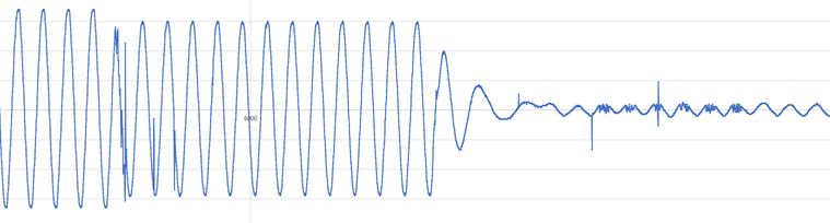

My disturbance recorder has been sitting on the desk in a half finished state for a while now.
Today was it's day to shine.
We are having some severe electrical storms passing by. The closest strike I recorded on the lightning detector system was 0.8kM away in a neighbours spud paddock.
The picomite recorder was ready and this is one of the 'disturbances' recorded.
So far, all the micromites and picomites have survived but there is a few more hours of storms to go.

Nice recording...
But for your equipment not harmfull. Maybe at the neighbours house it is more dramatic...
You can clearly see where equipment switches off.

A textbook recording!
At cycle 5 you can see where the HV surge diverters have blown and are now are now dragging the line volts down about 10%, till the MCB trips or HV fuses blow. Then 2 to 3 cycles of arc quenching.

could I ask how Jim got such a nice graph .png from your Pico ?
I've thought about using GFXterm then take a screenshot,
(excellent GFXterm does not seem to work with the picomite edit.. for me anyway)
I tried to write a minimal graphic terminal with PureBasic,
(it's too difficult or I'm too dumb )
..interesting post, thanks all!

This graph was compliments of Excel.
The data was saved to a file on the pico then I download the events at leisure and drop the data into an excel spreadsheet.
I usually start with excel and then, once I have the data collection right, put it into a purpose built program (PureBasic)
In the disturbance recorder, the end result will include the ability to step through the data a page at a time using the LCD display.

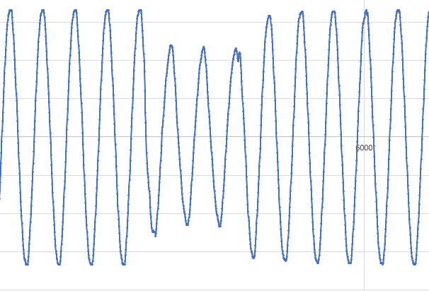

Another disturbance from the same 18 hours of storm cells.

A brief dip like that could be a stick blown across the line.

Neutral gene, 3 phasa unbalance, Someone else tot 300 volt. 60ms. Part of theorie disconnected.
