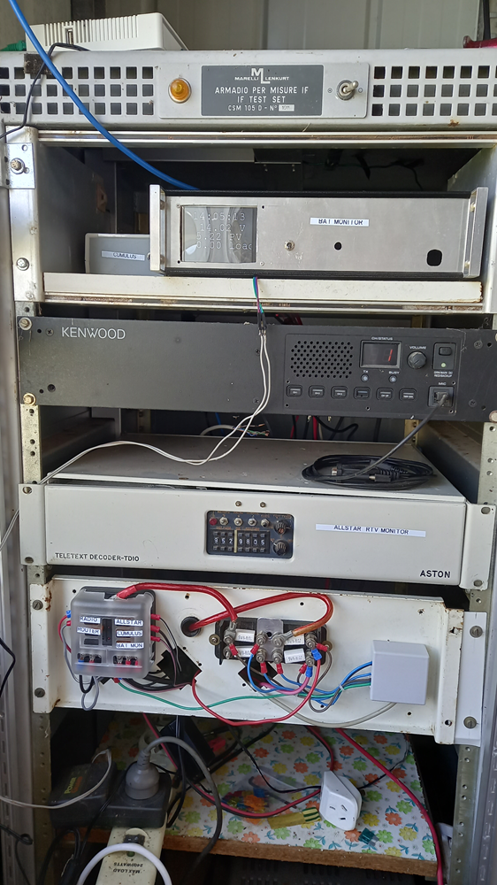

The rack:
Top of cabinet - router/accesspoint
Top shelf - RPi running cumulus weather software. Hanging of it is a picomite acting as a Davis weather station look-a-like, a micromite running my watering systems monitor and the adjacent box containing the armmiteF4 running the battery monitor.
The watering micromite will eventually hang of the armmiteF4 instead of the RPi.
Ser2net on the RPi gives me remote access to all 'mites.
Next is the Repeater radio
Then a WEBmite monitoring the radio and sharing the case with another RPi running Allstar internet radio linking software.
The WEBmite will get data from the Armmite in the next stage.
The DC distribution is next with the INA3221 in the small grey box on the right.
The mains charger which gets a bit of use in winter is out of sight.
Posts: 6101
Posted: 07:13am 19 Dec 2023
Hi TassyJim,
Good that you added an explanation of what it is. I could have been mistaken easily.
Teletext decoder ? Amateure radio IF test set ? I assume these boxes are used for their metal peices, and contain the circuits you describe...
Posts: 6603
Posted: 07:20am 19 Dec 2023
The rack cabinet and the teletext module came from a local telecom disposal sale.
Most of the other hardware came from my employer from 20+ years ago. They have been sitting in my shed waiting for a use.
I don't throw much out and I have a big shed.

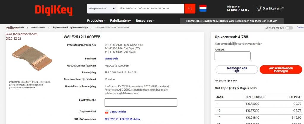

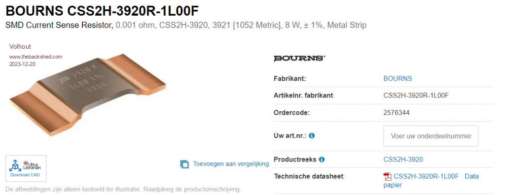

Posts: 6101
Posted: 09:08am 20 Dec 2023
@Lizby,
There are plenty 1 miliOhm resistors available (giving 163A range), such as:
But if you do not need to be accurate, why not use piece of copper wire.
There are plenty online calculators that tell you how many mili-ohm per meter/foot an AWG6 or whatever you use is. Then remove isolation at 2 locations of that wire that are X feet/meter appart, and connect to the INA3221.
1 mili ohm is what you would need.
The wire will have some thermal drift, but I am assuming you do not need to be 1% accurate. 5%-10% is definitely do-able with copper wire.
Posts: 3879
Posted: 02:52pm 20 Dec 2023
Thank you for the examples of what to look for. Appears not available at digikey, upwards of $20 from Mouser, and about $3.50 each for 5 in Chinesium for the shunt resistor.
Posts: 6101
Posted: 03:15pm 20 Dec 2023
Hi Lizby,
Digikey @$0.73 each, stock part.
It can dissipate 6 watt (@70 ambient), so of you want to run 100A continuous (equals 10 watt) you need to put a fan on it.
Edited 2023-12-21 01:16 by Volhout
