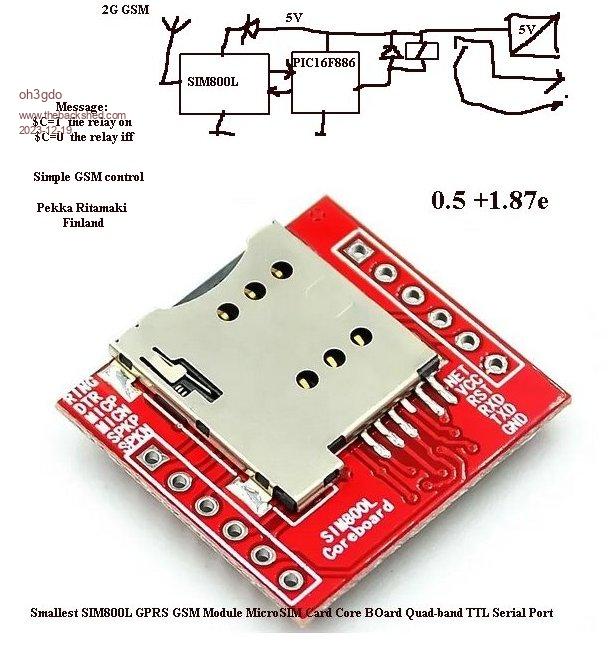

I have  done phone used dryer controllers about 20 years.
They have a small relay.
Here is the basic diagram of the device.
It needs a gsm module or a GSM modem.
The modem is easier to do.
Then you need a small processor.
I use always Microchip PIC cpus, but you can use any processor.
If you use a modem, you need a serial connection to the gsm modem.
If you use a gsm module, you use a uart connection
Then you need a program, which reads input from gsm.
It has a lot of work, but I think it is not a problem.
Please ask more

GSM/GPRS is phased out in many countries already. You could look at SIM7000 series.
