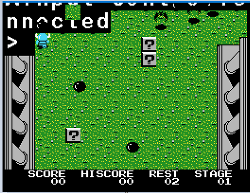

I have an Xbox gamepad, but first I need to check if this feature will work on wine. I'll let you know
LeoNicolas
Joined: 07/10/2020
Posts: 625
Posted: 04:26am 24 Dec 2023
I have tested the new version on Wine 6 (the default version from the Mint repos), and it failed with the following error:
0024:err:module:import_dll Loading library XINPUTUAP.dll
I updated the Wine to version 8, the last stable one, and everything worked perfectly. I also tested the analog sticks and they worked fine as well.
I'm using an Xbox gamepad connected to the USB port.
Edited 2023-12-24 14:35 by LeoNicolas
LeoNicolas
Joined: 07/10/2020
Posts: 625
Posted: 04:56am 24 Dec 2023
Unfortunately, running Knightmare on this MMB4W version ends in a crash. I don't know if the Wine implementation of the direct input is not stable enough.

Posted: 03:13am 24 Feb 2024
Hi Peter, the Xbox controller works well in Leo's knightmare game but when it announces that the controller is connected the game has already started and it overwrites the game's screen and doesn't go away. So the game must be restarted.
I guess there are work arounds but maybe if it didn't print the message and set an MM.INFO flag so that the programmer could check that and take the appropriate action that might make life easier.
Bill
