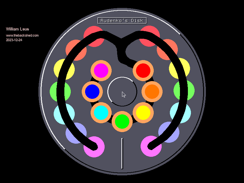

Here's another puzzle for you: Rudenko's Disk.
Rudenko.zip
(Requires a mouse, sorry!)
Enjoy!
-Bill

Hi Bill,
I tried to play this game on CMM2, and it throws an error in line 139.
error: no mouse attached
controller mouse open XXX,YYY
Any idea ? I have a mouse attached (OPTION MOUSE 0,0) and used the mouse to start the game.
