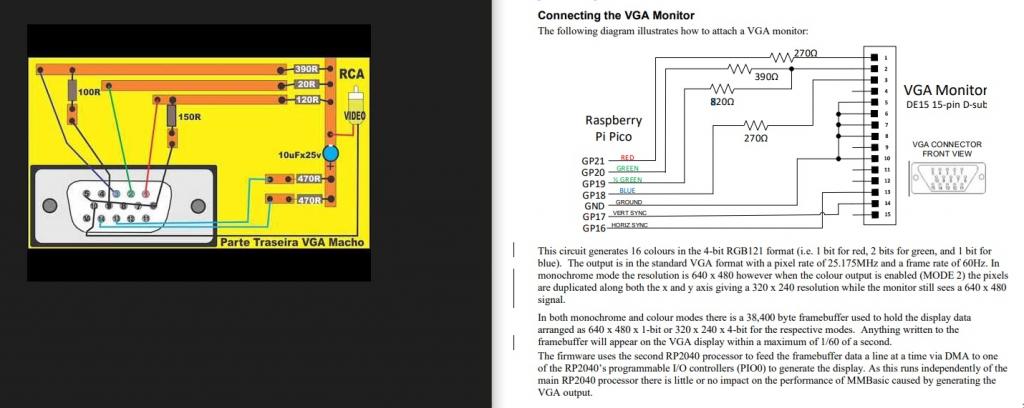

can this sort vga to avi? I got a few picture frames with avi input.
Posts: 8968
Posted: 10:57pm 07 Jan 2024
What you've shown in the RH circuit is how the PicoMite VGA hardware works to connect the Pico to a VGA monitor. I think the LH diagram is how to get a combined video signal into a VGA monitor.
Did you mean AVI or AV, which is the combined video signal?
AVI is a method of packaging video files. It has nothing to do with the hardware. To watch an AVI file you need a specific codec - a piece of software running on the Pico - to unpack the file and send it out on the hardware interface. I don't think the Pico could manage that.

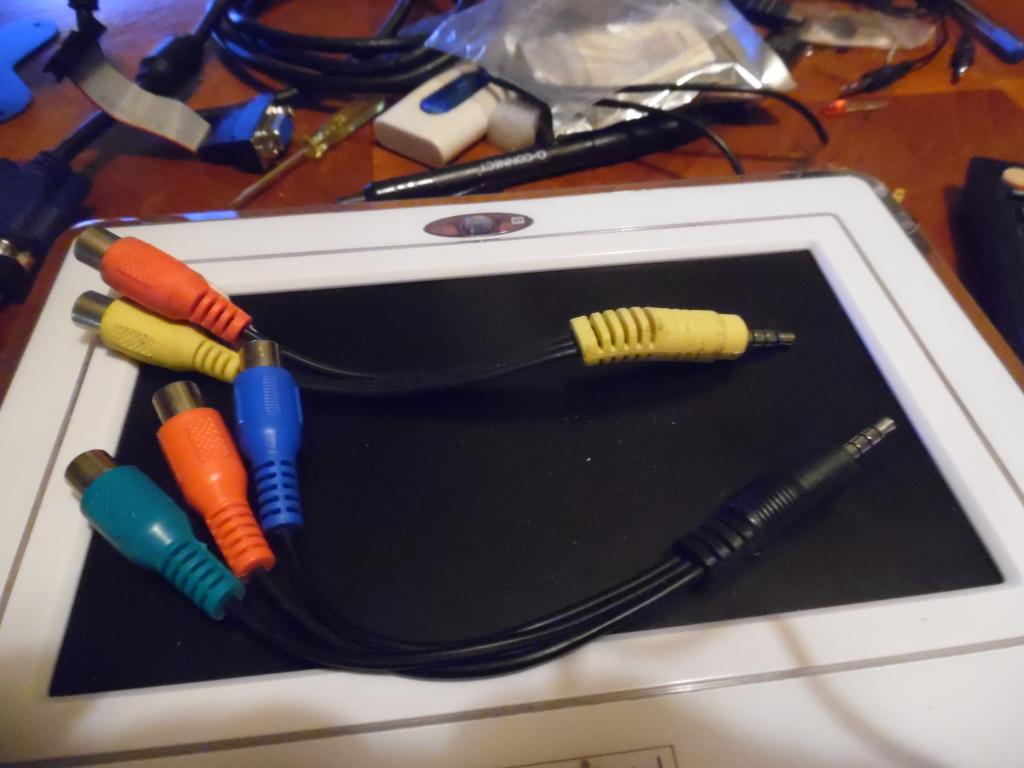

If I use 470r for vsync and hsync then join red,green,1/2 green,blue to hvsync after 470r and the cap to a composite video out.
the avi and stereo is not standard like one lead is gnd,left,right,vid
the other not. got a few of these picture frames so got to try

I want to join rgb and hvsync via 470r to composite avi. I'll try and let you know what happened.

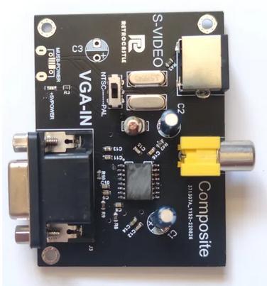

I think you need one of these Stan. The conversion is active, not passive.
Note - I won't guarantee that these boxes are the answer, you need to try one. Some of the old PC video cards had "TV" (AV) output on the VGA connector so it only needed an adapter cable. I wouldn't put it past the occasional Chinese manufacturer to fail to mention that there are no actual electronics in their boxes. :) These *look* ok though as they have control buttons. I have the reverse direction version of one of these that converts AV to VGA and that works ok.

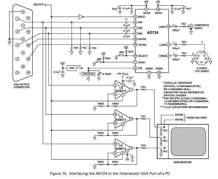

I found an active circuit but the idea was having the small displays and not spending more money.
Posts: 11657
Posted: 06:36pm 08 Jan 2024
  Quote  I found an active circuit but the idea was having the small displays and not spending more money.
The AD724 requires the VGA signal to be both interlaced and conform to the frequency of the output required (PAL or NTSC). It is not a generic solution and definitely won't allow connection of a 640x480 standard VGA signal

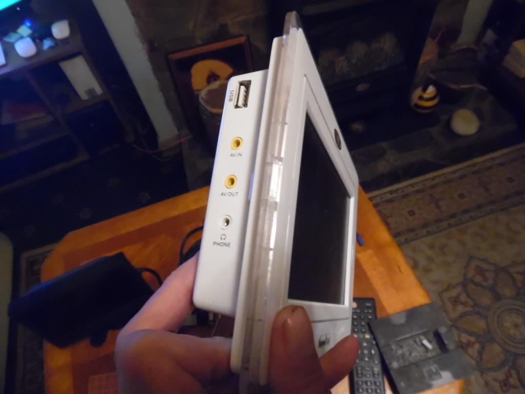

Hi John, these are 7" picture frames but only sd card,usb  mem, avi input. from charity shops for a few quid when they were popular.

The ad724 chip needs 15.625 kHz VGA video.
It is just a “modulator”, not  a frame grabber or frame rate converter.
There is no simple solution. You need to read the complete VGA screen (fast ADC’s, memory) then generate from this memory an interlaced video, then apply that to the AD724.
The kobalt terminal is black and white only.
