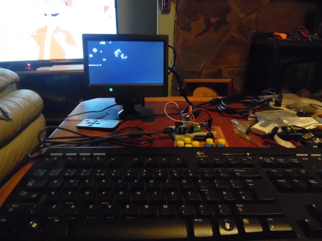

Recently been tinkering with getting an "art" project up and running, based on Conway's Life.
PicoMiteVGA to RCA adapter (Amazon) and one of those reversing screen sold for cars (eBay).
Here seen running... (don't judge the set up)

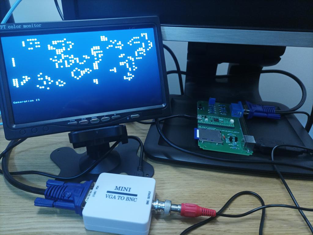

Nice VGA to CVBS converter. Some people on this forum are looking for such converter.
What is the type?

Mini VGA to BNC

The CVBS is as @lizby posted - had it for a while via slow boat from who knows where - another lockdown "treat".
Long term, i'll make up a PicoMite VGA on protoboard for this as I wont then need the SD card / Keyboard and it'll be quite compact then - ideally fit directly behind the monitor itself - the plan will then be to mount it on a self as "art"  -- Or so I keep telling my other half as I try to convince her I'm not a hoarder.

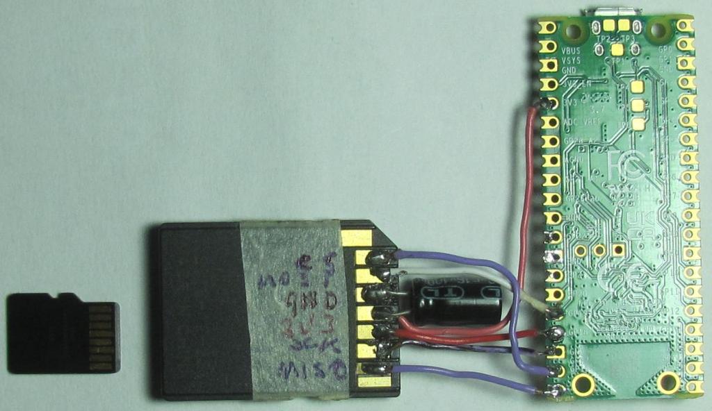

  Volhout said  The sd card may be essential. There are cheap, breadboard friendly modules.
Are the micro SD card modules functionally the same or do I need a full sized SD Card?
P
Posts: 3377
Posted: 11:13pm 09 Jan 2024
They are the same. If you have a spare micro/standard SD adapter here is an option.
SD Card pins (bottom view)
nc CS MOSI ⏚  3V3 SCK  ⏚ MISO nc

P
Posts: 3377
Posted: 11:41pm 09 Jan 2024
The cap filters the 3V3 supply and is optional, most µSD cards don't need it.
If the card doesn't always respond add 10µF, a 100µF was in front of me so I put it on, though not needed for that card.

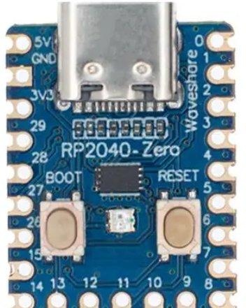

Posts: 9123
Posted: 08:22am 10 Jan 2024
@lizby
I traced the circuit of one of those uSD card modules. There are two supply decoupling capacitors and pullup (not inline) resistors on the signal pins. As the resistors are pretty high in value (10K) they don't seem to have any effect. I've used these a few times now with no additional decoupling and they've always worked well for me. Note, they are a true 3V3 module. There is no level shifting so they are ideal for a Pico.
Another fan of the RP2040-Zero. :)
