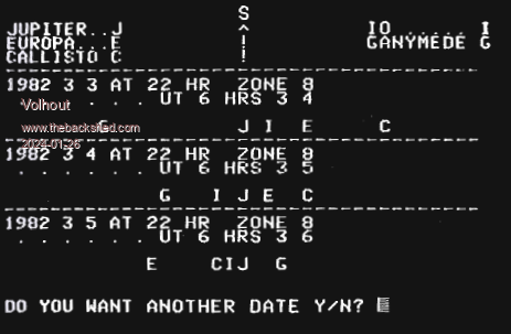

You can try this program:
JSATS.zip
It's from "Celestial Basic: Astronomy on your Computer"
Frank
