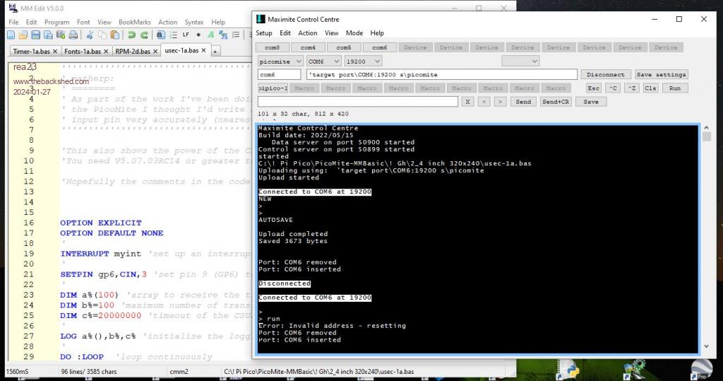

I would like to measure the shutter speed of old analog cameras. For this I use a laser and a phototransistor to measure through the camera shutter.
The post "A PicoMite CSUB to timestamp pin changes" describes how to measure microseconds. When I use the program, I get an error message after starting it. The CSUB at the end of the post is used. I can't find the reason.

There are updates to this csub, to make it work agan with 5.08.00.
See 10 posts down

Posts: 3377
Posted: 09:57pm 26 Jan 2024
As Volhout says, the latest re-compile by Disco4now works well with V5.08.00 firmware.
I got the same error when using the previous re-compile on V5.08.00 firmware so I imagine the same would happen if using the latest Log with older firmware.
The only issue I have had is being unable to get out of the Timeout Sub that it calls when done, so I don't use that Sub.
Instead test for the last element of the array to fill or a shorter timeout than the Log Timeout.

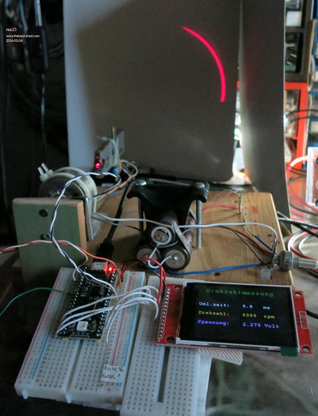

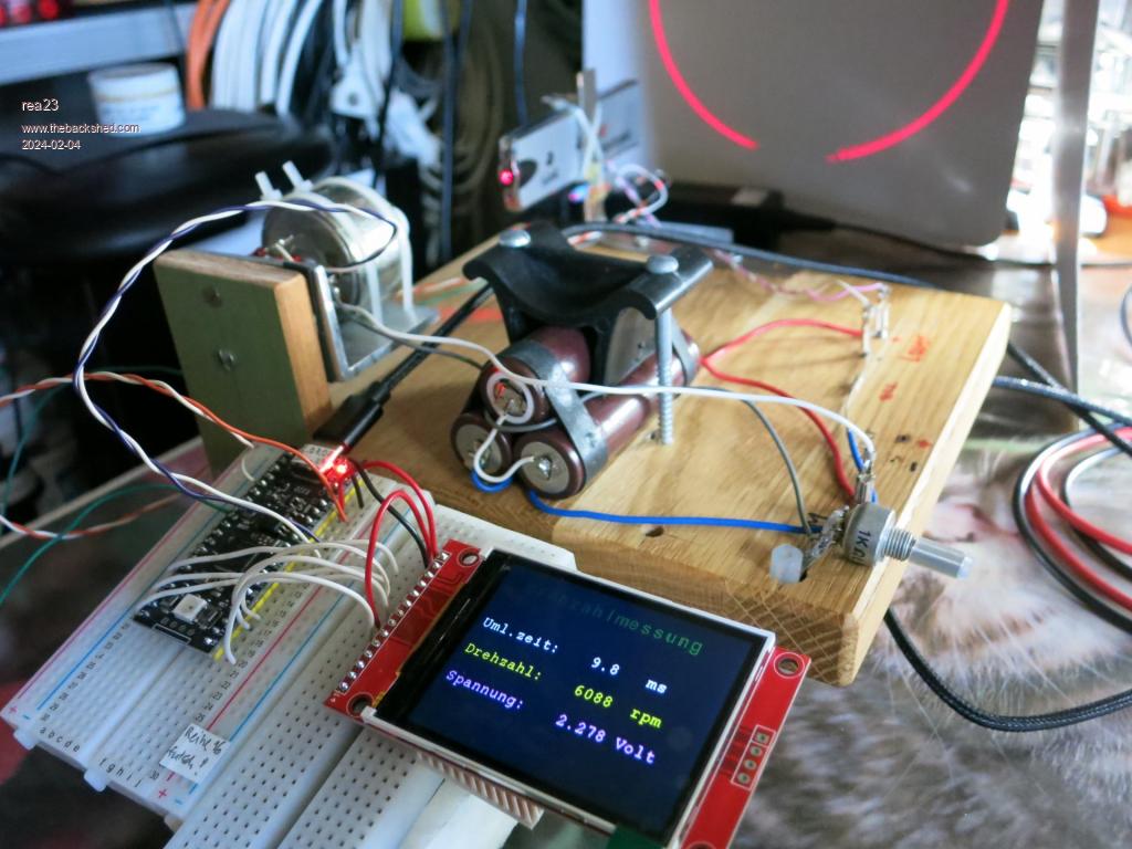

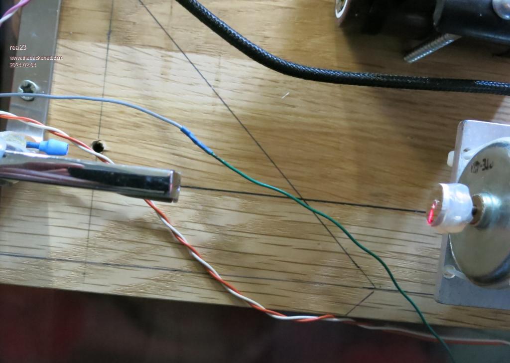

rea23
Joined: 16/09/2022
Location: Switzerland
Posts: 26
Posted: 02:35pm 03 Feb 2024
@ zeitfest
Because I have been assembling stereo cameras for years, I have long had a device that measures, how well the two cameras trigger synchronously. In the pictures you can see that an inclined, rotating mirror creates a circle with the laser. If the stereo camera images this circle at e.g. 1/1000 s, then the displacement of the two circle segment of  left/right cams show the quality of the synchronization. With my two Canon S110, the result is approx. 1/12,000 s. Incidentally, the times are very accurate with digital cameras. I use the SDM (Stereo Data Maker) firmware extension.
The method is therefore also suitable for measuring shutter speeds, if the rotation speed is known. BUT: With analog cameras, I don't want to use film for this purpose every time! This is the reason why I want to measure the shutter speeds directly (with or without lens).
