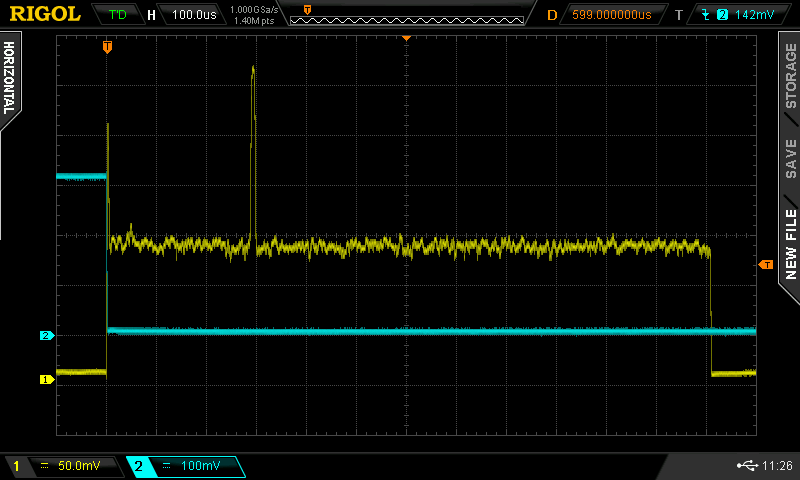

looking at the STM32F407VGT based Black boards, some ALiexpress vendors
offer STM32 chips or GeeHy APM32 chips.
Supposed to be interchangeable.
there are differences.
One thing I have found is the ADC .
I tested it using my FFT code (with options for FFT size, sample rate etc.)
No changes were made to the code loaded into both boards.
I used the Arduino IDE with STM's support package for it.
test condition is
sample rate: 500kHz
sample size: 2048
ADC resolution: 12 bits
Flat top window
time average: 8 traces (smooths out the noise)
20 db/vertical division
1V p/p 60kHz sine
Blue trace is a sync pulse for the DSO trigger
Yellow is the FFT magnitude. 0 to 250kHz over 12 divisions
First is the STM32F407

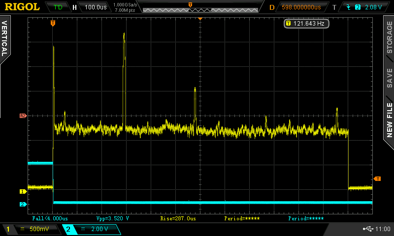

then the APM32F407
It is clear the APM32 has an inferior ADC design.
The second harmonic of the 60kHz is -42db
The APM chip also has another harmonic at -60db
The STM chip has nothing above the noise level
but this is a few db more than the APM uC
I have tested this at various sample rates from 500Hz to 500kHz
and that 2nd harmonic is always there, no matter the signal frequency.

Hi poida,
This looks a bit like the issue with the RP2040 ADC.
That 12 bit ADC also degrades to a 9 bit ADC because non linearities caused by bad capacitor matching on the chip.
