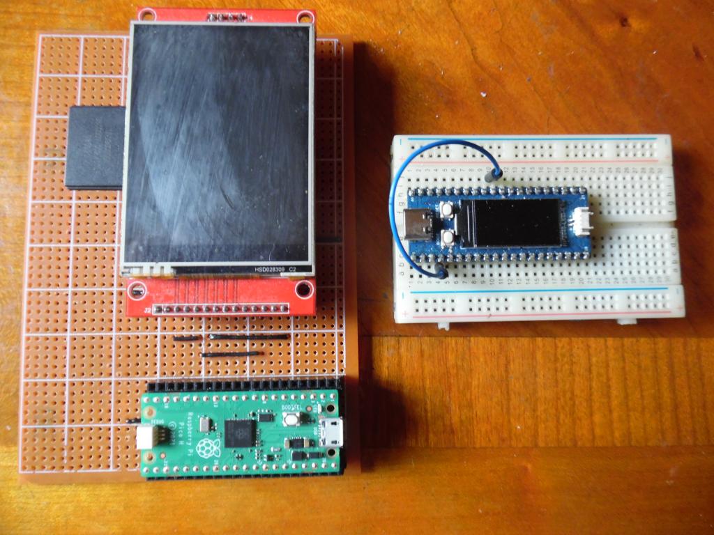

I was tempted to buy a Waveshare 'Geek' (just to play with really) but whilst looking at their site, realised that for another £5 I could purchase another 2.8" LCD touchscreen instead. I already had one which I plan to use as part of a (battery powered) control unit.

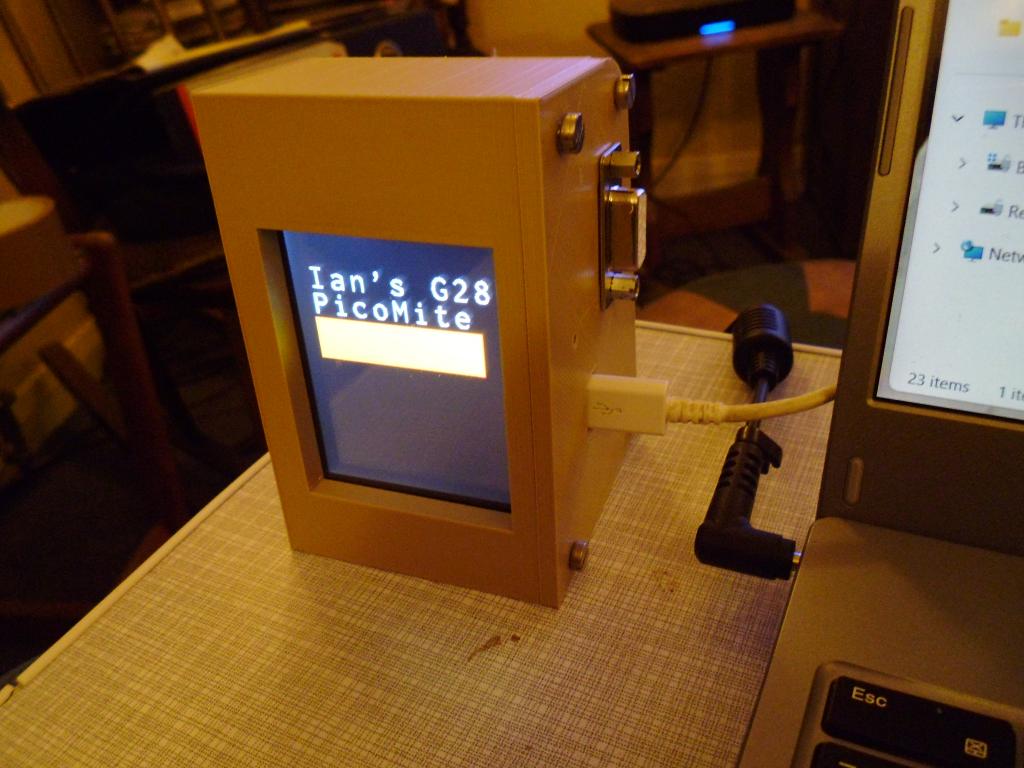

The WS LCD has a more useful touch screen & comes with SD card storage. I've stacked a pico-proto PCB on top of the Pico to access the spare GPins. A 3D printed case and USB cable gives me a handy plug-in unit to develop with instead of my usual Pico + breadboard set-up. Not as small as the Geek but my new 'device' will be more usful I think

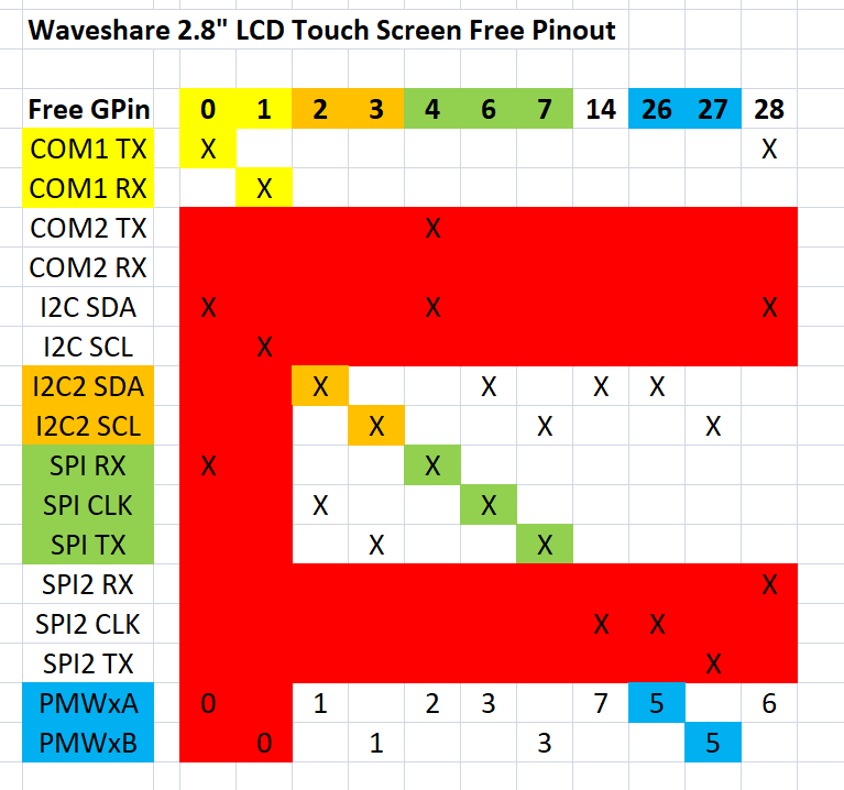

I then spent some time trying to work out (free) GPin usage. I'm going to use a 9-pin D connector (because I already have some). I was managing to get quite confused over which pin should/could do what. Eventually a spreadsheet really helped. I'm sure all the Gurus here will know this already but for other non-Gurus (like me) this really helps to see what you need to do.
This is a map of free GPins versus their functionality. It quickly becomes obvious for instance, that COM2 is not usable because only COM2 TX is availabe. So that defines 0 & 1 as being my COM pins and starts narrow down the options. Same with SPI2
which is used by the LCD.
I found this very useful and hopefully I'm not teaching everyone to 'suck eggs'

PS I was going to call my device a 'Geek 28' but it's easier to type 'G28', so that's what it will be. If anyone wants the STLs I'll provide them but not sure how best to do it here?

I had a bread board set-up like that one already Stan but decided I could use the WS LCD as my 'attached' system. It won't slip in my pocket like a 'Geek' but I can actully read stuff on the screen and use the touch feature when needed. It's 100mm tall and sits besides my PC quite nicely - although some countersunk screws might help the appearance.
I can also re-purpose the parts if I find a better use for them. All it's cost is some CAD time and PLA filament.
