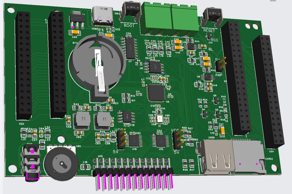

Existing PCB designs for LCDs all suffer from the slow speed of transfer to the screen so I thought can I get the Pico to support a full 16-bit parallel RGB565 I/F and still make it useful?
The answer was NO
However, I could get it to support RGB555 and that one pin makes the difference. With the new USB support for Keyboard, mouse and game controllers the allocation of every single pin on the RP2040 is not the issue it would have been previously.
Here is the design:
3e2a4967-01dd-411f-8f0d-87a8da272427.pdf
The intention is that this design can, if you wish, be used completely standalone with the LCD acting as the console device and, of course, a USB keyboard for input.
Pins GP0 to GP15 are the data pins for the LCD except that GP5 (least significant bit of green) is not connected and G0 on the LCD is connected to G1
GP16, GP17, and GP18 are the control lines for the LCD. The reset line is connected to the processor reset which in turn is controlled by a proper reset controller chip (TCM809)
GP5 and GP19 are used for the touch I/O (CS and IRQ)
GP20, GP22 and GP23 are SYSTEM SPI
GP21 is the SDcard chip select
GP24 and GP25 are the SYSTEM I2C and control the RTC and a pair of 8-bit port expanders (TCA6408)
that individually can be selected for 3.3 or 5V I/O and connect to a 20-pin card-edge header
GP26 and GP27 are the audio output pins and output via a line level jack and stereo PAM8302 amplifiers
and finally
GP28 and GP29 are the serial console connected to the outside world by a ch340 USB to TTL convertor.
The USB-C connector for the serial console also provides the power.
I've included interfaces for both 34-pin and 40-pin LCDs so that covers:
2 variants of ILI9341
All variants of SSD1963 up to 7" (480x272 and 800x480)
and both types of 4" 800x480 LCD (OTM8009A and NT35510)
The  reason for pairs of both the 34-pin and 40-pin headers is to allow screens of different sizes to be roughly centered, however 1 or both of the duplicates may not survive the layout phase.
Thoughts?

Nice, but the "old" PicoMiteVGA firmware with PS/2 is still supported? For me I don't see the need for USB and it would be bad if I now have to abandon all my picoMiteVGA PCB designs.
-Daniel
Posts: 8968
Posted: 07:15pm 10 Feb 2024
This is an alternative to the VGA - it's a much-upgraded standard PicoMite. The display will be fast as it's 16-bit parallel - good for the larger screen LCDs. It will also make good use of colour on those displays (you get more colour on LCD than you can get on the PicoMite VGA). So, it's different to the PicoMite VGA, not a replacement for it.
Comment for Peter:
The thing that would bother me most would be the choice of the TCA6408. This appears to be SMD only, but all the data pins are exposed on the GPIO connector. Any damage to a pin is a SMD replacement rather than simply swapping a DIL like a MCP23008 or something similar. Alternatively a Pico could be used as a GPIO output (it's a bit big though).
Edited 2024-02-11 05:25 by Mixtel90
Posts: 11657
Posted: 07:16pm 10 Feb 2024
  Quote  Nice, but the "old" PicoMiteVGA firmware with PS/2 is still supported?
Yes, of course. If you download the 5.09.00 beta you will see there are now 3 variants.

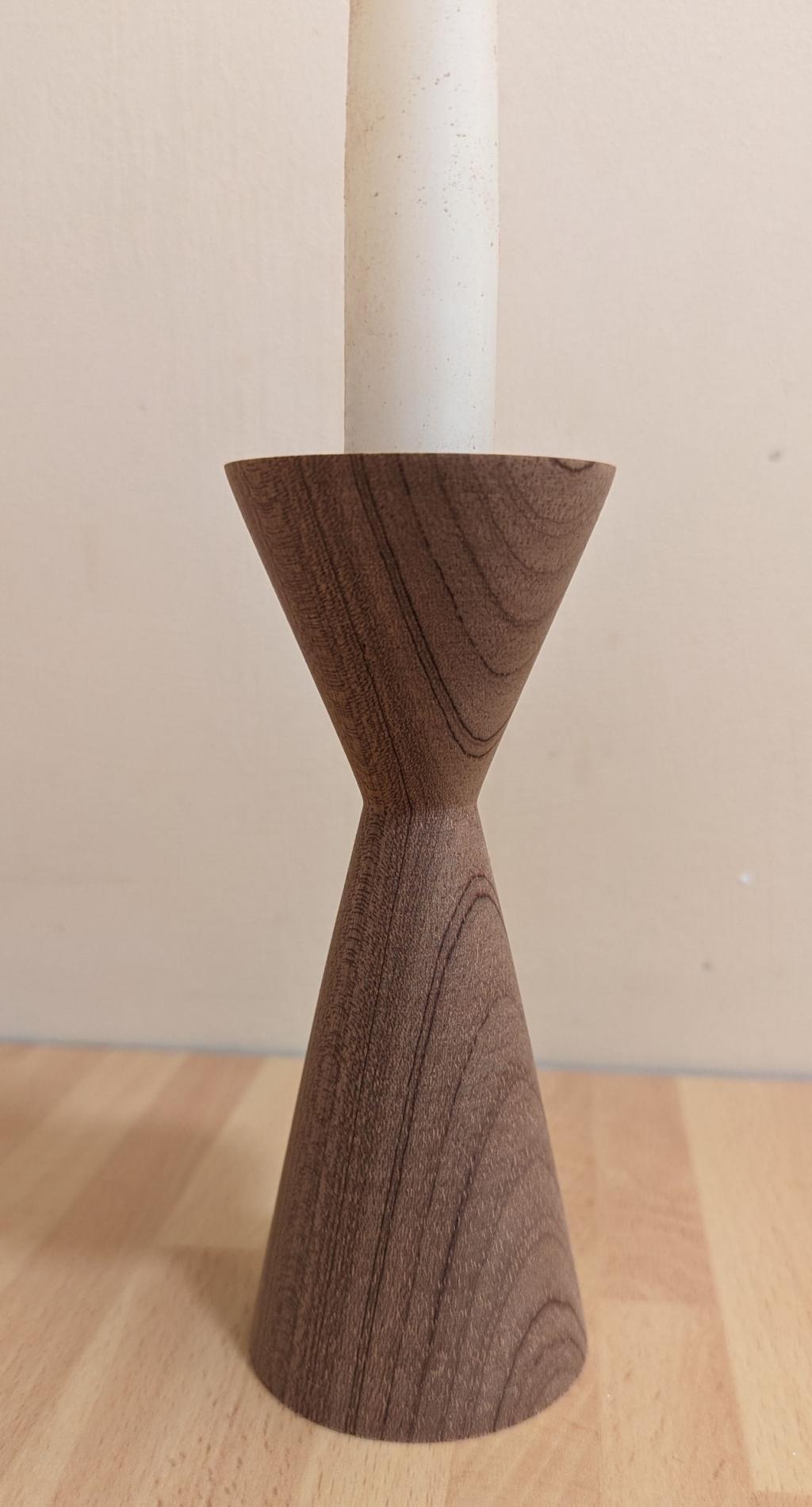

  Quote  You need to get a hobby
Got lots. Turned this earlier today (new old lathe arrived yesterday)
Posts: 4379
Posted: 07:18pm 10 Feb 2024
  matherp said
  thwill said  You need to get a hobby
Got lots. Turned this earlier today (new old lathe arrived yesterday) ...
I'm very jealous.

Interesting ideas. would i2c to parallel display be same speed as to i2c display?
a dual dil port expander also and no stereo amp, power from usb
Posts: 8968
Posted: 10:37pm 10 Feb 2024
A graphic LCD RGB555 display over I2C would be painfully slow. It's not practical because there's a lot of data to transfer. What matherp is proposing is probably the fastest RGB555 display you can get on a PicoMite. The price you pay is the number of GPIO pins used, hence the port expanders to get some back.

Hi Peter,
By connecting G0 to G1 on the LCD, can you still configure the LCD driver correctly ?
I assume the data lines are also used for configuration.
Can you still do hardware scrolling on the SSD display ?
Edited 2024-02-11 21:02 by Volhout
Posts: 11657
Posted: 02:36pm 11 Feb 2024
  Quote  By connecting G0 to G1 on the LCD, can you still configure the LCD driver correctly ?
No, I realised this last night too - I'm going to have to try and multiplex the use of one of the pins or something. This problem only arises with the need for a serial console on the USB version. The standard PicoMite has enough pins assuming all I/O is through the port expanders.
  Quote  Can you still do hardware scrolling on the SSD display ?
Yes
Edited 2024-02-12 00:41 by matherp

Posts: 2981
Posted: 10:26pm 11 Feb 2024
Hi Peter, All,
Do you think that by using a pair of fast 8 bit latches (1 high order the other low order) and 9 GPIO you could still get the required 16 pins, albeit with 2 x 8 bit loads using the 9th bit to control which latch is read to.
Then both latches (together) provide the 16 required bits.
This will no doubt be slower than direct 16 bits but still should be considerably faster than a single SPI.
The sequence could be like, enable high order latch, write relevant 8 bits, enable low order latch write relevant 8 bits, enable TFT, clock in the latched 16bits.
Yes requires extra latch circuitry but I think is a possibility.
Just tossing it out there for consideration.

@Peter,
Assuming you do not want to use the 6'th bit of green (G0) for video data, but do want the bit diring setup, you could use the LCD display D line (distinguishes between register write and scrren write) to switch a 74LV1G18 (single gate mux) on the GP5 pin. Then the pin is used for Touch CS when you are writing to screen, and touch is disconnected when setting up the LCD driver IC.
The 74LVC1G18 chip is a SOT23-6, and is easier to solder than the RP2040, much easier.
You have to use pullup(CS)/pulldown(G0) resistors for the outputs, just to make sure they are in controlled state when not used.

Posted: 07:24pm 13 Feb 2024
I've been thinking more about this and the best solution I can come up with is combining TOUCH_CS and SD_CS on a single pin with an inverting transistor to one of chip selects. By definition, since they share the same SPI bus, only one can be low at any one time. With a bit of thought it should be possible to also allow both to be high by putting the output in high-Z mode.
If any of the electronics wizards want to propose a simple circuit to get all three states from a single pin I would be very appreciative
The truth table I want is
Input      Output 1      Output 2
HighZ       H              H
low         L              H
high        H              L
Edited 2024-02-14 05:40 by matherp

I was looking at your circuit earlier today, wondering if there was a way to use it with the YD-RP2040. I hope it's me that's messed up, but is it correct that GP6 is going to two adjacent data pins on the display?
I can get your truth table with a twin op-amp (or comparator) and 5 resistors...
bias the pico output to 1.fv
use a string of 3 resistors to get 1V and 2V points for the op amp inputs.
it's like a 555. - on the top is linked to + on the bottom is linked to the pico output.
Now the top op amp goes low if the pico is high and the bottom op amp ios low if the pico is low.
