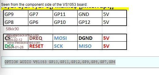

for several days on and off i've been trying to get my Webmite to work with the VS1053 board.
I've followed several threads on here and failed to get it to work, either in midi mode or playing streaming media.
I have tried two different types of board, one has an SD card onboard the other does not, all the wiring has been like this
I need to also say that the VS1053 boards both work fine with an Arduino.

As a test , I put a 100pF capacitor from the XCS pin on the VS1053 board to ground, probably more capacitance than the scope probe, but it was to hand, and with the cap in place I cannot get it to fail either playing midi or playing the streaming media despite several power on and off cycles.
The wiring between the Pi and the VS1053 board is hard wired, about 2" long.
Without the capacitor on the XCS pin to ground it will not work at all.
This applies to the VS1053 PCB with the SD card and the one without.

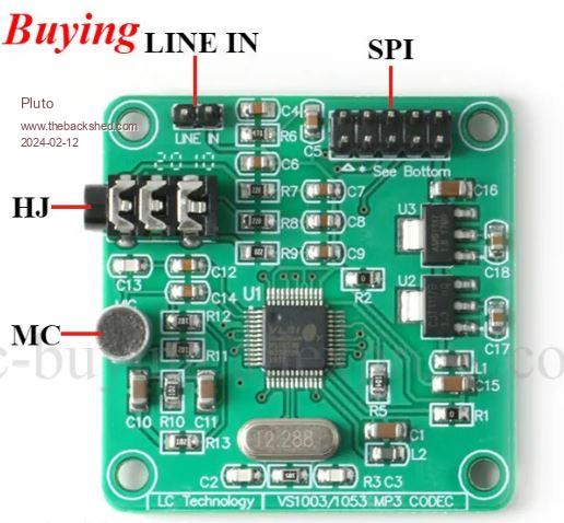

Posted: 01:10pm 12 Feb 2024
This is the module I am using. Should be the same as matherp used when developing the VS1053 function.
Please check that the chip is VS1053. The text on the board says VS1003/VS1053 MP3 CODEC.
Works ok for many internet radio channels, but not for all. The imnternet channels in Finland are all concentrated to one web-site. Unfortunately not useable for VS1053. At least I cannot get it playing properly.
