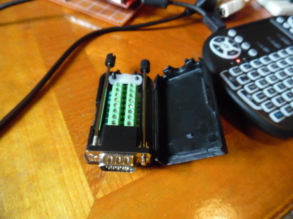

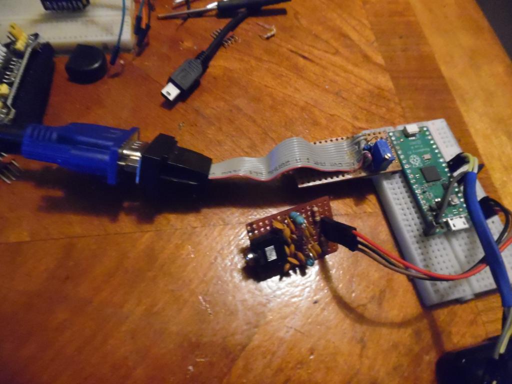

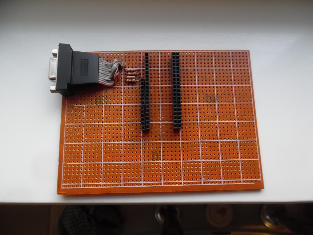

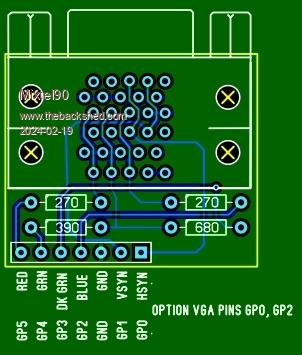

oops. If you want to use vga then you'll find the vga socket is not strip board friendly so any thoughts the pcb designers to make a board to accept vga socket and maybe resistors and 7 pin to plug in picomite board.
you can buy breakout boards but no.
This is faulty but you can see the messy wiring.

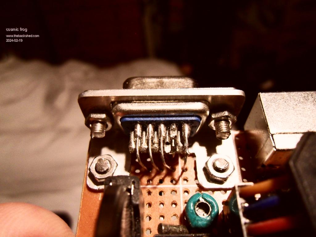

I use a staded chassis mount VGA socket and make a bracket out of angle aluminium.
Posts: 2807
Posted: 06:19pm 18 Feb 2024
Ask if this would be useful, using vga needs a socket, how do people use one?
strip old graphics cards for wired vga?
something to replace this mess

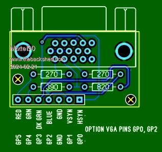

Posts: 8968
Posted: 06:35pm 18 Feb 2024

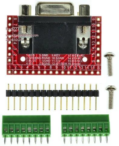

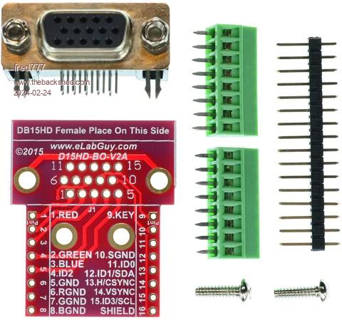

Any use?
Takes two alternative VGA sockets.
New version already. :)
Plugs straight into the breadboard by the Pico.

Why 2 vga?
First one with one vga would be ideal but with the wiring of the second to use standard vga in the manual pins. nice one

  cosmic frog said  I use a staded chassis mount VGA socket and make a bracket out of angle aluminium.
/QUOTE]
I was going to use right angle plastic and a dremel and wires a la yours
Posts: 8968
Posted: 08:30am 19 Feb 2024
The pads are for two different VGA sockets. Many of them are the larger size, but some people might have the compact size available. I prefer that one but it's not easy to find in the UK and I had to get some from China. You can't install both at once. :)
My personal preference would be for the second version with the compact socket. It's less to have overhanging the breadboard and there are no wires needed at all.
Another possibility is to include GP8 and GP9 on the same board, together with a USB-C to TTL adapter, which could also power the breadboard at 5V (or even 3V3 if you limit it to less than 100mA). :)

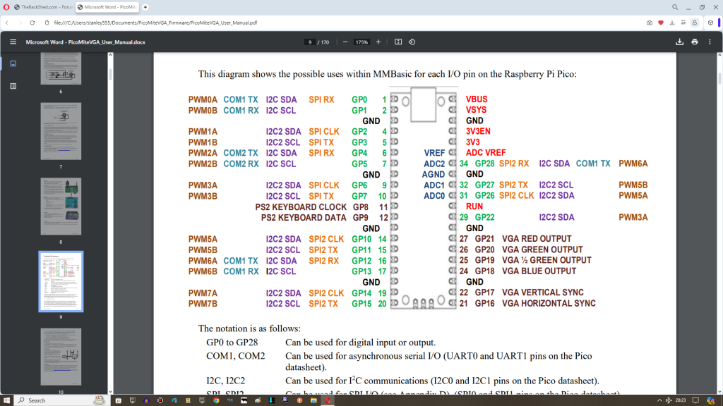

Posts: 2807
Posted: 03:55pm 19 Feb 2024
Hi Mick, in the manual 1/2 green is 820R, you use 680R. there about is ok?
I bought a vga breakout plug but could have just cut a vga lead and soldered the end to the board.
Posts: 8968
Posted: 04:48pm 19 Feb 2024
Nothing is critical. 820R is correct and my brain isn't.

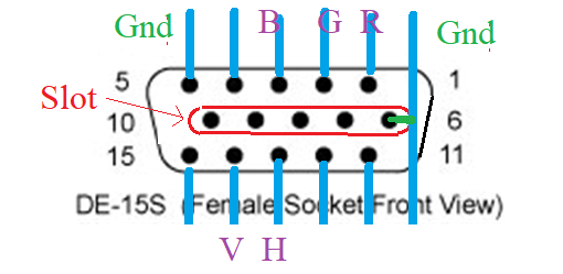

Posts: 3323
Posted: 10:21pm 19 Feb 2024

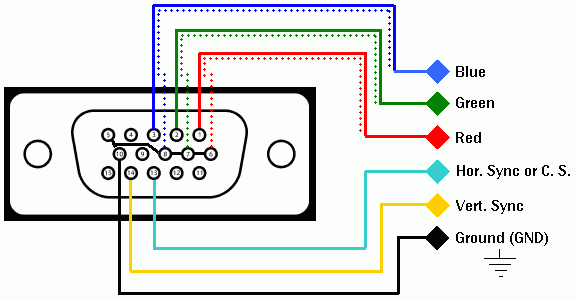

For short VGA leads a single ground wire works ok.
For very long leads a separate ground for each colour is needed as they are co-axial, and one for sync. Some have another ground for the data signal (not used on the Pico).

Posts: 3323
Posted: 11:59pm 19 Feb 2024
My PicoMiteVGA is also on strip board. As the Pico only uses the centre (offset) row for ground I used a Dremel to cut a slot in the board for those pins. The last pin of the centre row (the one that sticks out from the other two rows) is then bent a little to solder to the adjacent track.
Viewed from the top side. Reverse for the track-side view.
You could also make the slot by drilling out the centre row of holes to a larger size then tilt the drill left and right to join the holes.

cosmic frog
Joined: 09/02/2012
Posts: 308
Posted: 05:01pm 20 Feb 2024
  phil99 said  My PicoMiteVGA is also on strip board. As the Pico only uses the centre (offset) row for ground I used a Dremel to cut a slot in the board for those pins. The last pin of the centre row (the one that sticks out from the other two rows) is then bent a little to solder to the adjacent track.
I quite like this idea, I wonder if header pins could be fitted to the VGA sockets top and bottom row and a header socket (female) could then be fitted to the Vero board, that way the "slot" would not be needed as the VGA socket would be raised above the board. Maybe? The ground pin would still be a problem though.

I dunno.... I design a lovely little PCB to put you all out of your collective misery and nobody wants one....

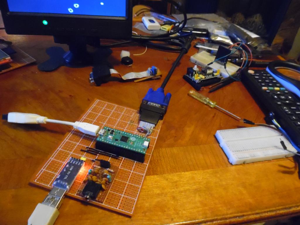

Posts: 2807
Posted: 05:32pm 20 Feb 2024
It's everyone wants a solution. boards on ebay. it's getting all the bits and a pcb is permanent. I only wanted one vga picomite for now and the vga wiring I thought fault just needed the securing bolts on the vga screwed or bad connection.
I bent the pins on the usb to ttl and mounted it upside down and soldered the audio filter. bit nore solid than strip board.
Posts: 8968
Posted: 05:51pm 20 Feb 2024
So what's wrong with having a piece of test gear permanent?
You don't have to put male pins on it anyway - the holes are on 0,1" centres so line up with veroboard. You could have a couple of fixing holes if you like.
A set of 5 identical 100mmx100mm PCBs costs about £3.80 including postage to the UK IIRC. As they are all the same design, compare that with the cost of a piece of fibreglass stripboard 100x100mm including postage.
You can easily get four of those VGA boards out of a single 100mm x 100mm piece, so that would be 20 of them for less than four quid. Soldering them in is realistic.

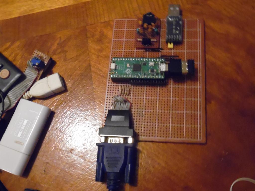

Posts: 2807
Posted: 06:34pm 20 Feb 2024
Hi Mick. I just used vga from old pc cards. If I had a vga socket with right angle leads then you only need 6 pins so cut the excess and bend the others. I'll look up vga socket types and price.
I screwed 2 self tappers through the vero into the vga and used araldite. bodge but solid.
I'll have 5 boards £3.80. tell me how please. regards stan
