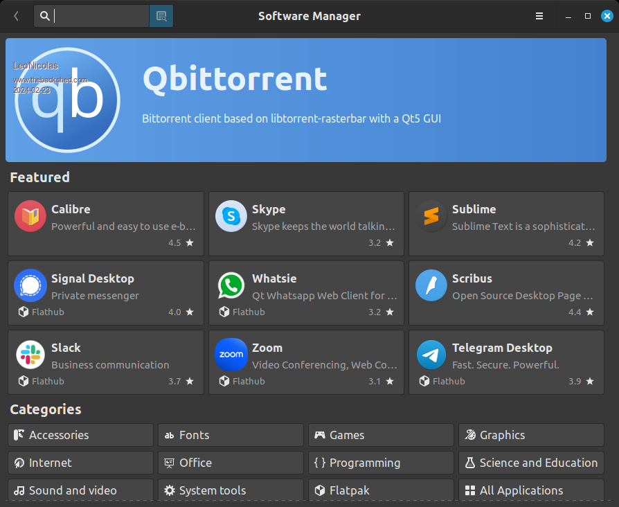

Still playing about with Linux Mint, and thought I would give WINE another go, as it has been updated many times since I last had issues with it.
Unfortunately, Mint only gives you the option of installing(via the software manager) WINE version 5, and they are up to version NINE now....

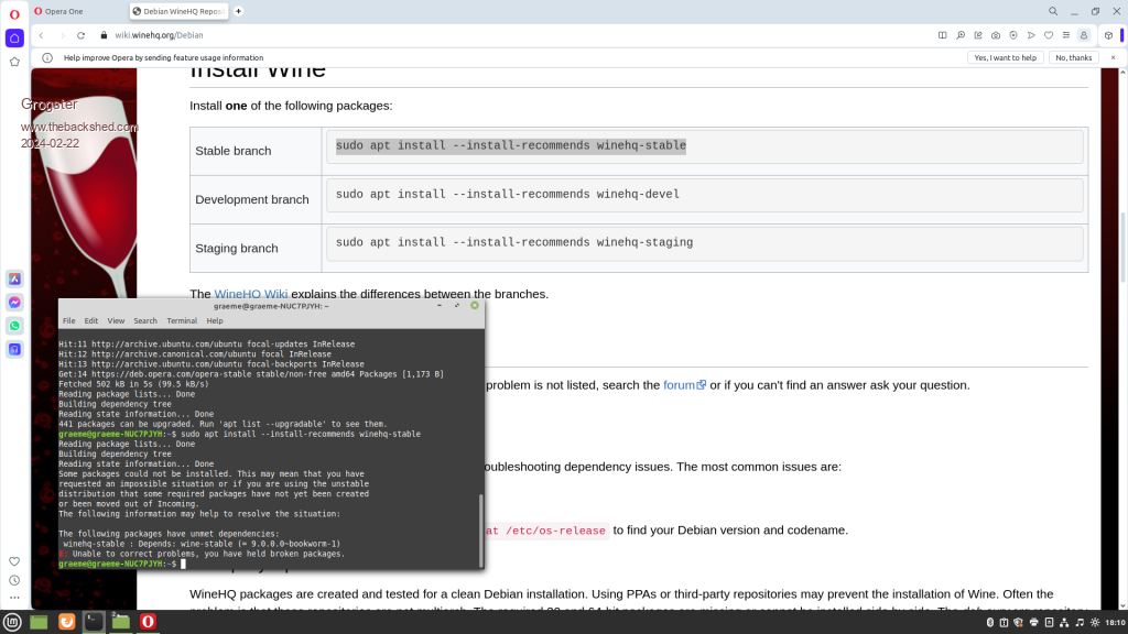

So, I tried to MANUALLY do it, using the WINE HQ instructions, but it fell over and died when I tried to actually install WINE:
The instructions I was following was from this link.
All went fine, up until I tried to actually install WINE.

Can anyone help with what Linux is moaning about in the screenshot above, cos I don't even understand what the problem is - "You have held broken packages."....
WTF does that mean?!

   as far as i can tell, version 9 of Wine is not supported by Linux Mint 21.3, see:
https://askubuntu.com/questions/1504207/when-i-try-to-install-wine-on-linux-mint-21-3-it-says-an-error-more-info-on-er
it looks like you need to instead install Wine version 8:
https://wiki.winehq.org/Ubuntu
"Ubuntu 22.04
(Jammy Jellyfish)
Linux Mint 21.x
sudo wget -NP /etc/apt/sources.list.d/ https://dl.winehq.org/wine-builds/ubuntu/dists/jammy/winehq-jammy.sources
as John said, Wine is an enormously complex piece of software, and the latest release (version 9) makes use of functionality that is only included in Ubuntu 23.xx, whereas Linux Mint 21.x is based on Ubuntu 22.04.

I'm using Linux Mint 21.3 and Wine 9.
Software in Linux is, in general, is installed using a package manager. Linux Mint is based on Ubuntu. Mint 21.3 is based on Ubuntu 22.04, which is based on Debian. To install Wine 9, you must use the Ubuntu 22.04 repository.

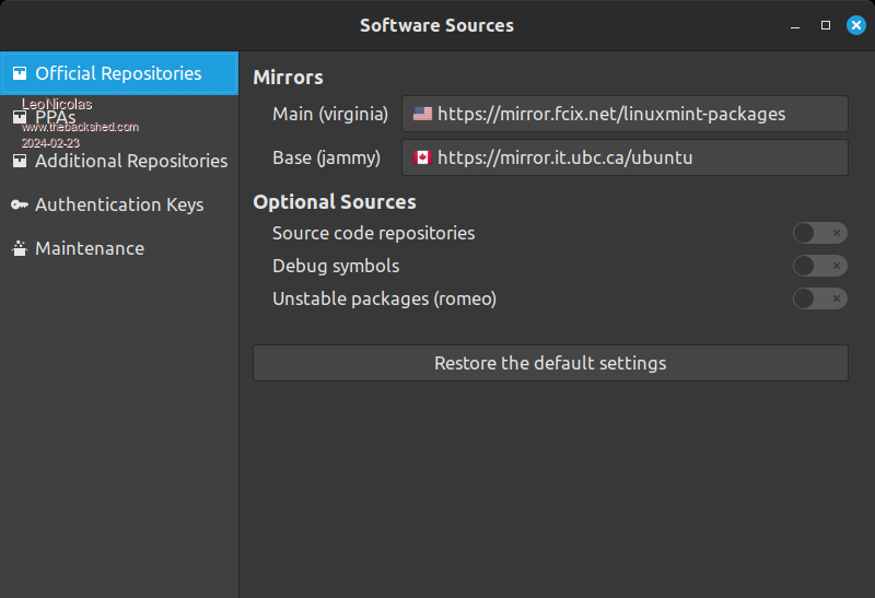

Mint's package manager is APT, which uses repositories to fetch the available software list. The distro comes with APT configured with the distro repositories, which can be extended with new repositories. Each repository is signed, and to add new ones, you need to install its key on your computer.
The repositories configuration files are stored in/etc/apt/sources.list.d
You can use the UI to add and remove them as well.

I think your error is related to using the incorrect Debian repo, which has libraries in a version not supported by your Linux Mint.
You can try:
1) Uninstall wine "sudo apt remove wine-hq-stable"
2) Clean APT "sudo apt autoclean && sudo apt autoremove"
3) Delete the Debian source list. Use the Software Sources app or delete its file from /etc/apt/sources.list.d
4) Run "sudo apt update" to update you local packages list
5) Follow the instructions from https://wiki.winehq.org/Ubuntu adding the repo from Ubuntu 22.04

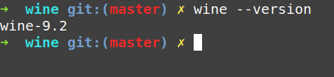

Mint is very conservative with new stuff to keep the system stable. This is why it is always based on the Ubuntu LTS versions.
Yes, you can install new versions of most of the software, including Wine. I was using the Wine 9 stable. Now, I'm using de 9.2 (dev) to test the fix for the input crash. I am working with the Wine dev to test it (see the bug post). And it is running on my Mint 21.3 with no problems.
