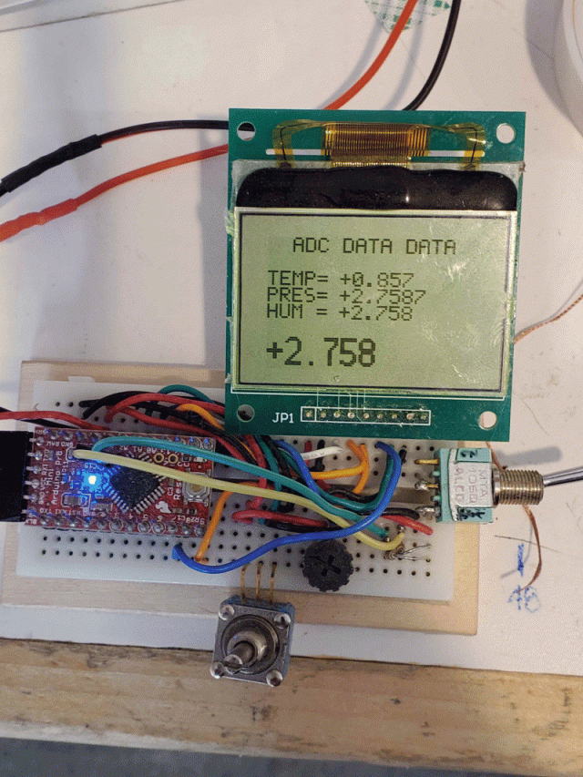

The subject is click bait, I thought about saying "Free Beer" but I can't deliver on that.  I have 10,000 of these little mono Alps displays with an EPSON 1565 Driver with LED backlight, a 32 pin 2" Kapton Ribbon (pics and docs below).  The active area is exactly the size of a small "post-it" note, 2" x 1.5, 100 x 64 pixels, there is a bit of extra height in Z for the ribbon and COG driver- .25 inch.  Operating voltage is 2.5 to 5.5, I use them mostly at 3.3.  There is a 4 level charge pump built in.  I have boards that are setup for 3.3v with the caps and FPC type ribbon termination.  Did I mention that I have 10,000 of these in factory trays?  I paid a buck each for these a while back- long story.  The project dried up and I've stored them in an indoor cool spot for quite a while.  The display quality is similar to the Nokia 6100 Mono 84 x 64 displays but are 100 pixel wide, etc.
I've been on the Maximite/Micromite train since inception- I really love the Micomite with the MX170.  I thank Geoff and Peter for all their efforts.  Most of the stuff I've done has used standard Hitachi 44780 modules- they really work nicely.  I've written a Basic level LCD driver that works but is super SLOW.  I started with a published driver for the SED1306, its a somewhat similar resolution OLED and I tweaked it to drive my display.  It installs as an MMBASIC lcd drive and works. This effort is attached as EBLCDDRIVER.TXT, it installs and works mostly- its just really slow.  I think the reason that it is so slow is that it has the LCD memory arranged vertically and the SED1565 is arranged horizontally.  This seems to be how the MMBASIC installable driver works.  I also wrote and attached an Arduino app that takes in 2 pots through the ADC and displays their values- with 2 font sizes with all the functions that I need- text and cursor control.  I wrote this in straight C but am stuck trying to make a speedy LCD driver for MMBasic especially in C.  I would appreciate any help, will deliver ten displays, etc for any help.

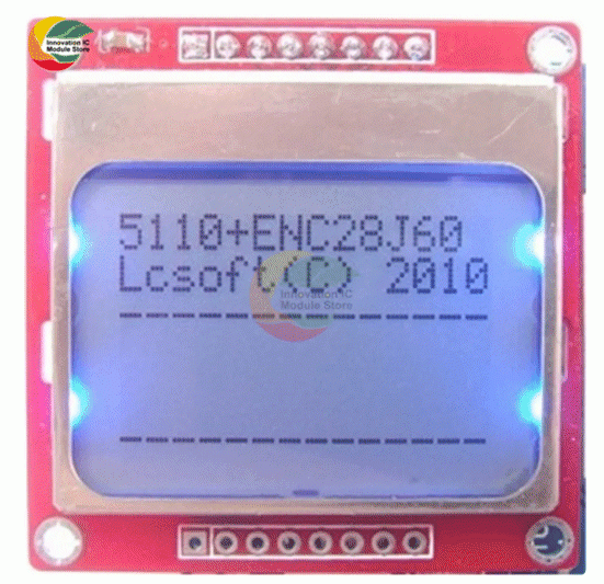

Is this different from the Nokia5110?

Yes- it is different- Nokia is I2C, 84 x 48, uses a totally different driver with different memory layout- the only similarity is the approximate size.  The board its on is designed by me. The actual displays are bare glass with a chip on glass driver (SED1565) and kapton ribbon.  My board has the charge pump caps, etc to make it 3-3.6v display with SPI input.  The post above is the display on my board running my arduino code on a nano.  That code is attached above in the zip file.  Thanks.
